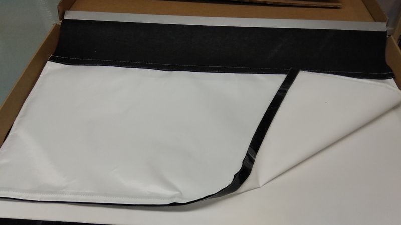

One other thing (I've never used) - there is an accessory coming with printer that can be hooked on the heaters inside (cloth with vynils and metal strips for printing on soft materials) - meaning when printed material goes over bottom heaters to avoid burning and melting - worth to try accessory.

I don't know the accessorie you mentioned, but I'll check.

This accessory looks like this:
