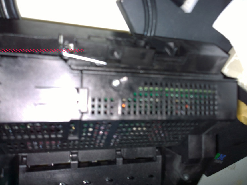

here it is , see red arrows. I have another z3200 with 79:04 error, even no print, no paper load & when carriage box move to left & error came up, I could not fix it for over 6 months.
Now I realized might be the same 02.1:10 error instead.

I could be off base here but I do not think the carriage bushing missing will not cause the original error report in this thread. Most times if the carriage bushing is missing you will get the 86:01 where the carriage hits on the side as it tries to move since it is sitting to low in front since the carriage bushing helps raise the front of the carriage to the correct height. Jason I think you caused the original poster to think the carriage bushing is the issue when it is not. The error relates to an electrical problem with the main board reading the carriage which is caused by a bad or incorrect connection of the trailing cable or an actual issue with the board on the carriage assembly.

thanks for your hints. My Z3200ps 44" had been working flawlessly for over 5 months. Then all of sudden it stopped & error o2.1:10.
When I opened the right cover & the rear bushing I clued & taped completely broken, which made me think it is the origin of problem. Then I replaced another broken one I glued & very harden & no flexibility like the new original . error still
remain.
I bought 2 brand new one & coming from Hong Kong. Will see..
I did a carriage box test & mostly were pass till asked me to remove the pens ? I did not know what are the pens ( printheads ?? ) I just press enter , then it failed. I will do other tests also.

I read the carrige bushing affects the height of the printer heads to the paper and keeps them from scratching across the media the main reason I posted was the 02.1:10 error but the carriage bushing was also broken on my own HP Z3100 which seems to be a common problem.
Could you explain the electrical problems associated with the main board or a bad or incorrect connection to the trailing cable / carriage assembly.
I also read that the 02.1:10 error could mean the replacement of the complete carrige assembly was this what you are referring to mainly in your post.
