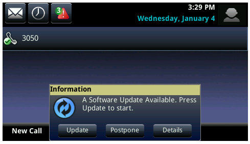

Postpone an Update:
The above can be combined with a new Parameter to let the customer delay an upgrade process utilizing UC Software 5.3.1 or later.
Example configuration:
<config prov.polling.enabled="1"
		prov.polling.mode="rel"
		prov.polling.period="3610"
		prov.userControl.enabled="1"
		prov.userControl.postponeTime="00:15" />
NOTE: Please be aware that if ZTP is being used this parameter is ignored!
The phone "pulls" after around 1h the new firmware that was placed into the directory after booting and then displays as follows:
Pressing Details will show:
There even appears a new SoftKey:
The parameter prov.usercontrol.postponeTime allows:
  • Configure a time interval for software update notifications. Permitted values for this configuration parameter are 15 min, 1 hour, 2hours, 4 hours and 6 hours using the format HH:MM. If a user configures an invalid value the default value is used.
After the period has elapsed this is shown:
