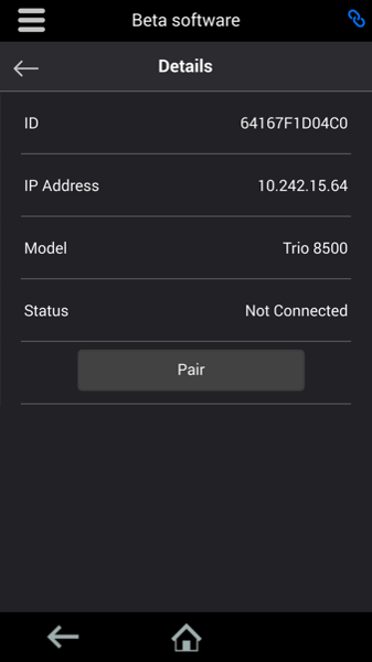

the Trio UC Software 5.8.0 added a new feature that enables to pair two Poly Trio C60, Trio's 8800 or 8500 to cover a larger room.

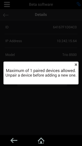

imageSet the network device role.imageSet Trio to be a Hub (primary) or device (slave)imageOn the Hub Trio, select the device to pair toimageYou may have to set maxDevices higher than 1.imageConnect to the device and you’ll see a Trio icon for the connected Trio device.

    <web mr.pair.maxDevices="2"​ />
    in addition the Mac Address of the device you want to pair with using
    <web mr.pair.uid.1="<MAC>" />
