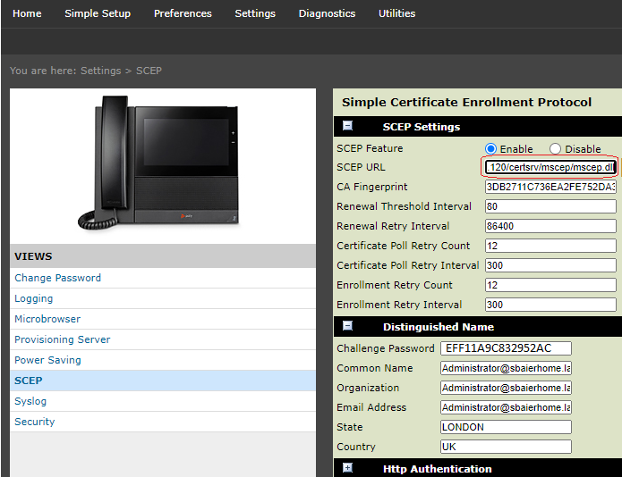

 Settings > SCEP > SCEP Settings

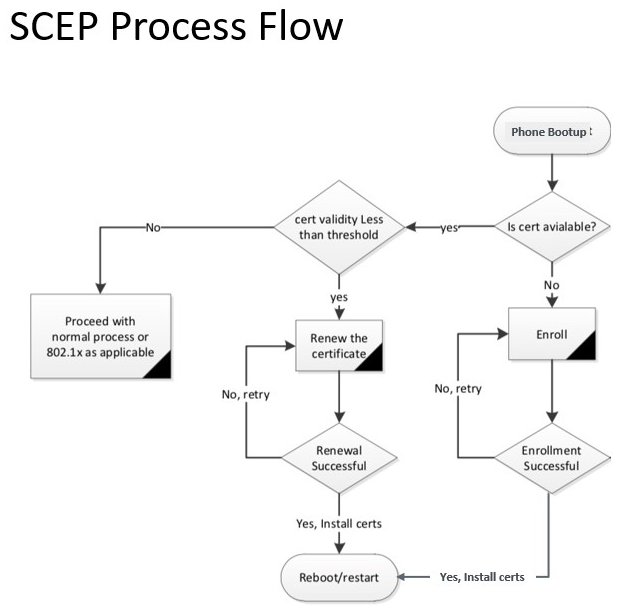

SCEP Process FlowSCEP Process Flow

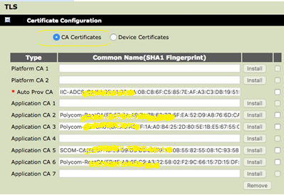

Settings > Network > TLS > Certificate Configuration > CA Certificates:
Settings > Network > TLS > Certificate Configuration > Device Certificates:

On a compatible Poly Phone navigate to Settings > SCEP > SCEP Settings
  • SCEP URL would be http://<IP or FQDN>/certsrv/mscep/mscep.dll

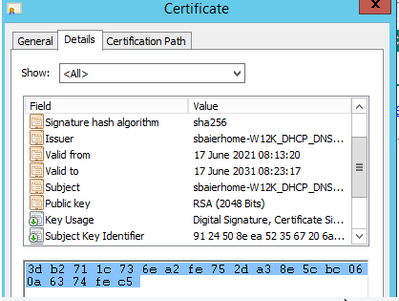

  • CA Fingerprint is taken from Root CA via http://<IP or FQDN>/certsrv/certcarc.asp > Download a CA certificate > Download CA certificate > Open File > Details > Thumbprint
  • Copy the Fingerprint and use for Example Notepad++ to remove the spaces and change to capital characters
  • Challenge Password is from http://<IP or FQDN>/certsrv/mscep_admin as outlined above aka EFF11A9C832952AC
  • Common Name, Organization, Email Address, State, and Country must be supplied or the SCEP process does not start
