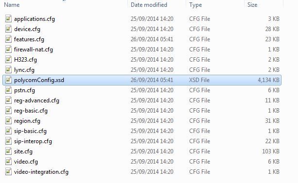

Since the introduction of UC Software 3.3.0 the \Config Subdirectory included in a downloaded Software from the Polycom support Page => here <= contains a file called polycomConfig.xsd
The above file holds the definition of all available parameters and their values
Example parameter voice.rxQos.avgJitter
xsd:attribute name="voice.rxQos.avgJitter" type="UInt_0_80">
  <xsd:annotation><xsd:documentation>number min 0 max 80 default 20.</xsd:documentation></xsd:annotation>
</xsd:attribute>
More details on XSD can be found => here <=

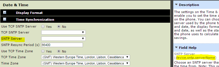

Since UC Software 4.0.0 the Web Interface itself also shows the parameters within the Field Help section:
The above shows the reg.1.protocol.SIP parameter.
The above illustrates the SNTP Server parameter actually being device.sntp.serverName shown in the "special" Device Parameter => here <=
