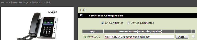

  • We import the certificate.pem to the phone via the Web Interface:
    Type the source address of the certificate.pem and click on Install
  • The certificate is now imported:
  • The certificate is now part of the phone configuration:
