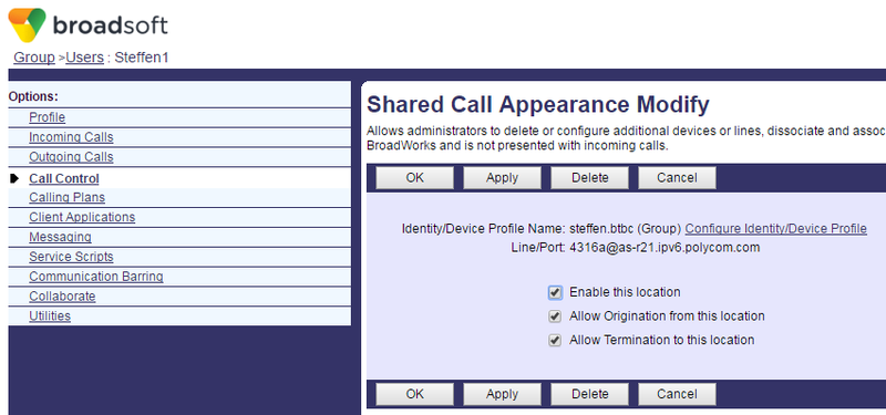

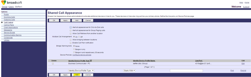

BroadSoft:
  • Call Control > Shared Call Appearance
  • The “Add” Option lets you add an additional Shared Identity. In my case it is 4316a

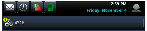

The VVX D60 will show the registration:

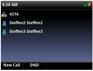

The VVX view when D60 is busy:
The D60 View:

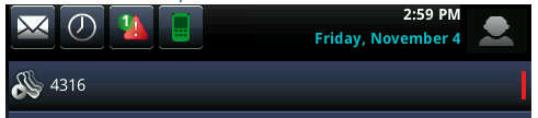

The VVX view when D60 has a call on hold:
The D60 View:
