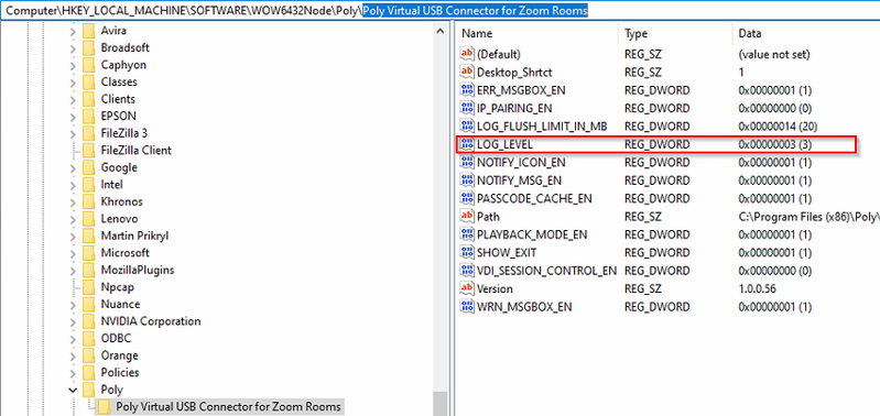

In order to Troubleshoot a user may want to lower the logging level of the Poly Virtual USB Connector for Zoom Rooms to a debug level.
NOTE: This should only be done if advised by Zoom or Poly Support!
Open the Windows Registry Editor:
For 64bit, navigate to HKEY_LOCAL_MACHINE > SOFTWARE > Wow6432Node > Poly > Poly Virtual USB Connector for Zoom Rooms
For 32bit, navigate to HKEY_LOCAL_MACHINE > SOFTWARE > Poly > Poly Virtual USB Connector for Zoom Rooms
Please change the “Log_Level” registry value to 4 (debug) or 5 (Verbose Debug).
3 LOG_LEVEL Log level (0 – 5) 0 – Any
1 – Err
2 – WRN
3 – Info
4 – DBG
5 – VDBG
