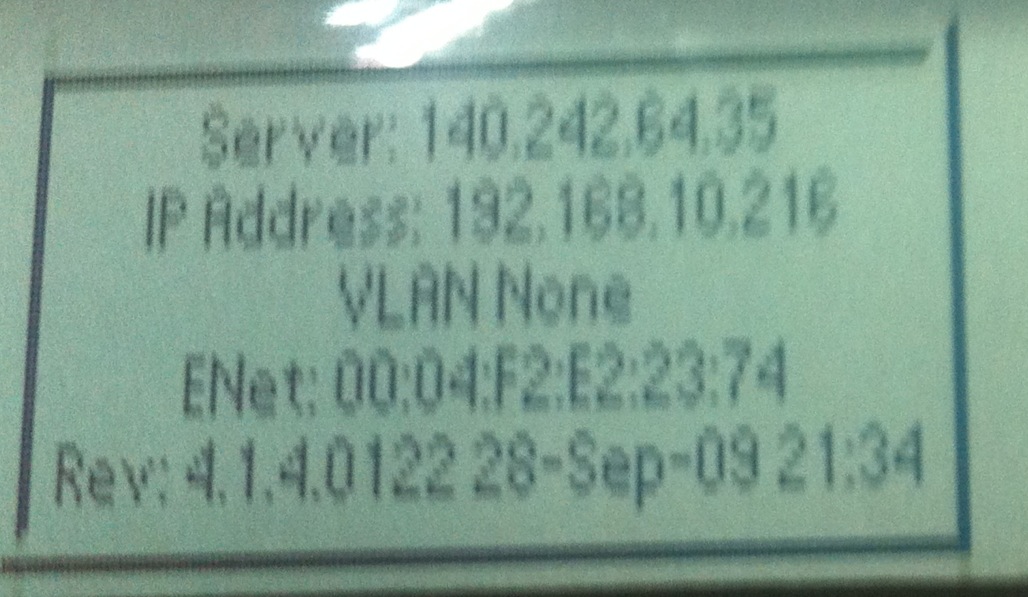

I was getting error 0x44020, Config Decryption Error, so I tried setting the <removed> server on my ip4000, and now I'm on Rev 3.1.7.0123, and I get 0x120 Config File Error. nothing I do seems to work, and it's stuck and just wants to reboot if I don't go back into setup.
Added: Also after I boot, and am editing, if I choose About it says 4.1.4.0122, not sure why i have 2 different versions.

4.1.4 is the BootROM, 3.1.7 is the SIP Version

Thanks for the link, and I tried the http://community.polycom.com/t5/VoIP/FAQ-How-can-I-setup-my-Phone-Provisioning-Download-Software/td-... article, but it didn't work.
I'm not sure what my settings should be, I tried Static, Option 66, custom, and 150,160, String IP address and put the server as: voipt2.polycom.com and nothing works, I just get Config File error 0x120. Do you know specifically what I should put in each field? If I need to point to a specific file or directory, I don't see where to do that.
