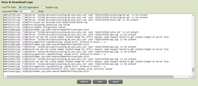

  • The phone appears to receive this - The logs show it is attempting to reach out but provisioning server settings do not show the information.
  • The phone never provisions to Poly Lens and never receives it's configuration. So while it shows it is attempting to reach out, it never goes beyond that.

!!!! Solved !!!!!
In the phone logs, I noticed these first two lines:
0807161749|cfg  |4|00|Prov|CfgDhcpInformControl::ExtractOptions: DHCP ACK message failed initial validation. Skipping parsing of DHCP options.
0807161753|cfg  |4|00|Prov|CfgDhcpInformControl::ExtractOptions: DHCP ACK message failed initial validation. Skipping parsing of DHCP options.
0807161755|copy |*|00|Server 't[#####].deviceprovisioning.dm.lens.poly.com' said '[MAC]-app.log' is not present
0807161755|copy |4|00|Could not set the custom header Content-Range for HTTP/s request. Head request failed to get content-length of server file.
0807161755|cfg  |4|00|Prov|cfgProvStatusSet: error code '22' respCode '403' desc '[MAC].cfg'
0807161755|cfg  |4|00|Prov|File transfer failed due to curl error code:22 and respCode:403
0807161755|cfg  |4|00|Prov|provStatusCbSynced CfgProvTransferringFileResult_CurlError: error code '22' respCode '403' desc '[MAC].cfg' provErrorPopupDisplayed 'F'
0807161755|cfg  |4|00|Prov|cfgProvStatusSet: error code '22' respCode '403' desc '000000000000.cfg'
0807161755|cfg  |4|00|Prov|Download of master configuration file failed
I explored this a bit and discovered that because there was a % symbol in my password, the phone was unable to parse the URL in the DHCP option it was receiving properly.  So while it was showing the provisioning server URL and username in the logs, the password wasn't parsing properly and was therefore failing to connect.
So I changed my Poly Lens password to remove symbols and updated my DHCP Option 66/160 URL and tried again, and it worked.
