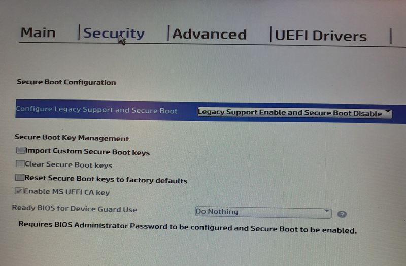

Today when I start my laptop then this shows an error
Boot device not found
So I restart and press f10  then  when I click on advanced ---》 secure boot configuration  ---》select legacy support enable and secure boot disable
Then I save changes and exit then always same error  occured.. kindly check attached screen shot
Image 1 : error occured
image 3: click on secure boot configuration
Image 2 : legacy enabled and secure boot disabled
Bit still did not work and same error happend

OK, so was that the ORIGINAL configuration? As in, was it originally set to Legacy disable / secure boot enable? Sometimes this will render the OS non bootable if you change it. Same with changing from Legacy to UEFI and vice versa.
If you run the F2 diags on the HDD does it pass?
Ok I did this but same error occured and yes this is original configuration...20191014_154629.jpg

When I click hard drive and then quick check.. then this shows message that " no hard drive installed please  check that the power and data cables are connected properly "
That would indicate that either the hard drive has failed or became disconnected.  Since that would indicate needed to open the case and locate the hard drive, check that the cables are still connected, since you will be able to check those.  If they are intact, unplug and then reinstall the cables.  If it then indicates the same thing, then the hard drive needs to be replaced.

Sorry to say, looks like your HDD has died and is no longer being detected by the system. You'll need to get it replaced.
