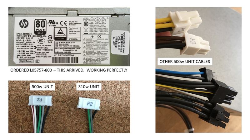

I’ve bought a 795-0030QD and had assumed I’d get my ATX 550w PSU out of my 500-209a and install it in place of the 310w unit while also putting in my MSI GTX1060 6GB 8-pin (it fits).  I’ve read the threads (and complaints) and obviously that isn’t going to happen.  If I want a 500w unit I need to order part L05757-800.  What I’m seeing though is a lot of parts listed as being interchangeable with this part (with big price differences) and in some images for L05757-800 one of other parts is shown.  They are (with some of the descriptions given):

Thankyou for your patience Wb.  So, ordered L05757-800 and what turned up was 901759-013 with a reference sticker to L05757-800.  The P2 connector for the new PSU has a similar pin colour arrangement to the replaced 310W unit BUT - has other pins as well.  I took the plunge and connected it up - all working perfectly so far.  Thankyou for maintaining the spreadsheet you posted, I'm not sure if this clears anything up or makes it more confusing!

I am sending you a spreadsheet link. The L05757-800 is the only 500W that will work.

I would expect that for the other parts listed the P2 cable would need to be re-pinned if they did indeed fit  Not to mention screw positioning etc.  If I ever get a chance to get my hands on one cheaply to test I'll let you know for the spreadsheet.  Given that there's thread here with the model# DPS-500AB-32 A part listed as the PSU for a 795-0030 there has to be some compatability:
 https://h30434.www3.hp.com/t5/Desktop-Hardware-and-Upgrade-Questions/Add-2nd-hard-drive/td-p/6974713
It's the same model number for some 901759-003 PSUs
Benny
