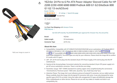

If you bought an ATX power adapter such as this purchase example which specifically mentions your HP Compaq 6000 Pro Microtower: Amazon.com: YEZriler 24 Pin to 6 Pin ATX Power Adapter Sleeved Cable for HP Z200 Z230 4300 6080 8080...:
Then you should be A-OK to go.  I have used similar ATX power adapters on a number of legacy HP desktops, and they have all performed just fine. Just watch the dimensions of your ATX power supply for fit inside your case.

Thank you kindly for the response. My cable does not quite look like the one you posted. It does not have that little jumper wire on the 6 pin white connector.
Maybe I should order the one you linked
@trentcreek,
That little jumper cable may not be crucial, sometimes it depends on a particular brand.  Like I said, if the ATX power adapter's link/specs specifically mentions your desktop, you should be good.  If it doesn't, then yes, perhaps you should buy the adapter I referenced.

It's been a long while since I bough5 the cable, but the description and look actually seems to more resemble this one:
https://www.amazon.com/Longdex-24-Pin-Supply-Adapter-Motherboards/dp/B08G89V1C6/ref=sr_1_3?crid=1Y8B...
I should probably go ahead and purchase the one you linked.
Though, I did find this diagram of a cable more like the one I have:
https://h30434.www3.hp.com/t5/Desktops-Archive-Read-Only/HP-Compaq-8000-Elite-power-supply-upgarde/t...
@trentcreek,
If it is the case that your ATX power adapter is catered for the HP Z2xx platforms, then it will not work for your desktop.
Better not try it either, in my opinion.
Kind Regards,
NonSequitur777
Thanks for confirming. At the time, it was the only adapter I could find, so I ordered it, hoping I could rewire it to use on the Pro 6000.
Again, thanks for the responses.
@trentcreek,
You are welcome.  If you are ordering the correct ATX power adapter, please let us know how things worked out for you.
Kind Regards,
NonSequitur777
I put the cable you linked, and a 850 Watt power supply. It worked out great. Thanks again!
