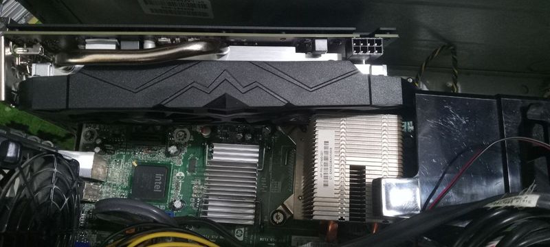

Greetings again. I ran into another issue with the computer. It seems fitting a double slot graphics card it not possible due to the CPU cooler in the way.
Any suggestions for an alternative?

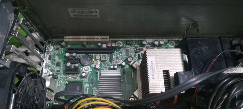

So the image is what I am dealing with.
Looking at low profile coolers, even they appear they could be too high. I was looking at Tower Coolers, but they never post all sides, and the dimensions.
02-28-2024 09:16 PM - edited 02-28-2024 09:19 PM
All right, let's see how we can remedy this. Please take the same picture at the same angle without the GPU.
Kind Regards,
NonSequitur777
02-28-2024 09:20 PM - edited 02-28-2024 09:39 PM
Here you go:

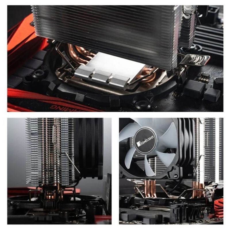

I found this on NewEgg, and the description indicates support for LGA775
https://www.newegg.com/p/13C-00UY-00001
It appears like it could allow the graphics card some space, but they do not show an image of the installation kit.
02-28-2024 09:38 PM
It's definitely a space issue. Since I have had experience modifying a number of heatsinks, my thinking was that I would trim the heatsink if it wasn't more than, say, 1½ cm.
Btw, what's the part number of the heatsink?
Kind Regards,
NonSequitur777
02-28-2024 09:42 PM - edited 02-28-2024 10:00 PM
The heatsink part number is 577493-001
It does appear that Cr-1200 Cooler from China could work out. Found some images on eBay
Reexamining, no. I see the current heatsink also stops at the same spot as the CR-1200; right at the edge of the metal CPU holder.
