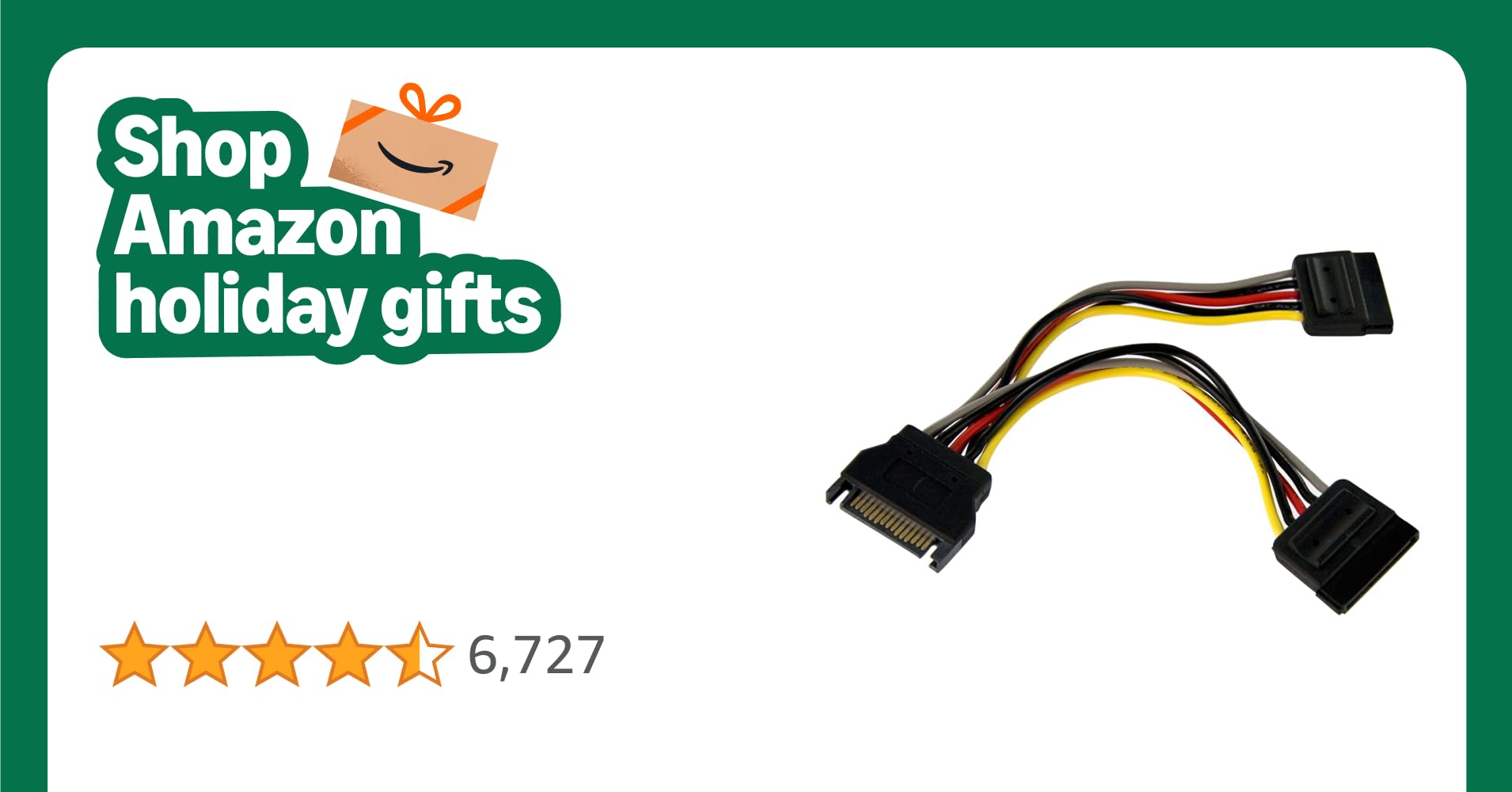

@Sxelent1 -- yes, an easy & inexpensive solution:
    https://www.amazon.ca/Startech-Com-PYO2SATA-6-Inch-Splitter-Adapter-M/dp/B002N2EHVQ/
converts one SATA connector into two SATA connectors.
Oh wow thanks, so all i gotta do is plug that into the sata port then plug back in the ssd and plug in the sata to 8pin ?

You could use that SATA "splitter" to use one power-cable to feed both of your SATA devices, and connect the other power-cable only to that adapter that feeds power to the graphics adapter card. That might make a difference, since both of your SATA devices only have "modest" requirements for power.

See: https://www.amazon.ca/Startech-Com-PYO2SATA-6-Inch-Splitter-Adapter-M/dp/B002N2EHVQ/
This power-splitting adapter is not too "big", if that is what you meant.
