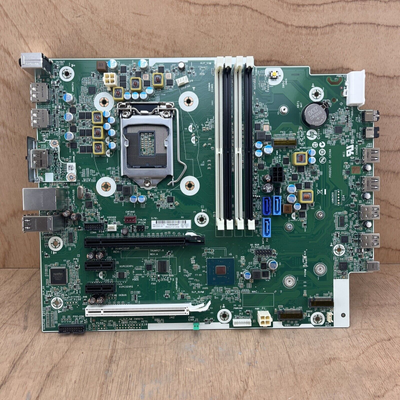

@NonSequitur777
In your build your PSU is a L08417-004, while mine is a L08417-002. I don't know if that makes much of a difference since they are both 250w PSUs, but maybe its something to note?
Things I also noted is that your motherboard was a L01482-001 while mine is a L65200-001. My motherboard also has L65200-601 on it. The previous Motherboard I had was a L01482-001, which is your model, but it didn't work either. Granted it was filthy.
L65200-001L65200-001
L22110-001/L01482-001L22110-001/L01482-001

@CAS97,
I used both motherboards: the L01482-001 motherboard (= HP EliteDesk 800 G4 SFF), as seen here in my 800 G3 SFF to 800 G4 SFF Upgrade: https://h30434.www3.hp.com/t5/Desktop-Hardware-and-Upgrade-Questions/Upgrading-HP-EliteDesk-800-G4-S... (this motherboard is now mothballed), and the L65200-001 / L65200-601 / L49080-001 motherboard (= HP EliteDesk 800 G5 SFF) is my current EliteDesk 800 G5 SFF Upgrade -using it right now, btw: https://h30434.www3.hp.com/t5/Desktop-Hardware-and-Upgrade-Questions/Upgrading-HP-EliteDesk-800-G5-S....
