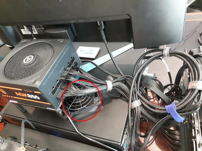

And here are a couple of pictures from my most recent legacy HP desktop upgrade project, an HP Z240 SFF:
Link: Solved: Upgrading HP Z240 Desktop Workstation SFF - HP Support Community - 8427878
What you see here is an externally parked RTX 3080 OC 12GB and an externally parked fully modular AGK850 watt AresGame power supply. The red circle shows an additional externally mounted desktop cooling fan I installed right above the internal CPU cooling fan in order to force/accelerate/boost airflow to cool the upgraded Xeon E3-1280 v6 processor.  This CPU cooling method works very well on all my upgraded legacy HP desktops.
Hope this gives you some ideas how to proceed.
