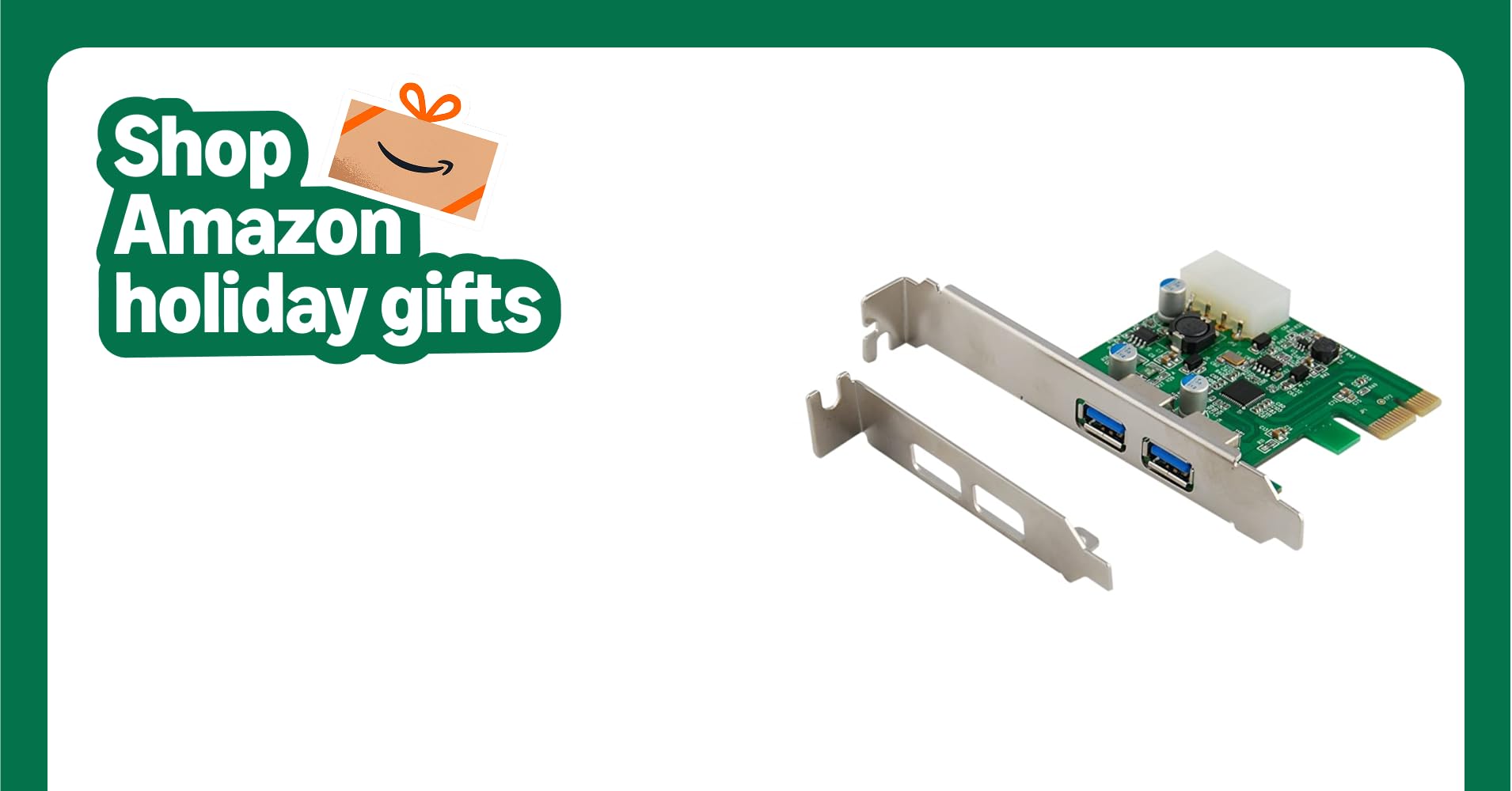

Here is example of two port
https://www.amazon.com/2-Port-SuperSpeed-Express-Controller-Card/dp/B0042U52KC

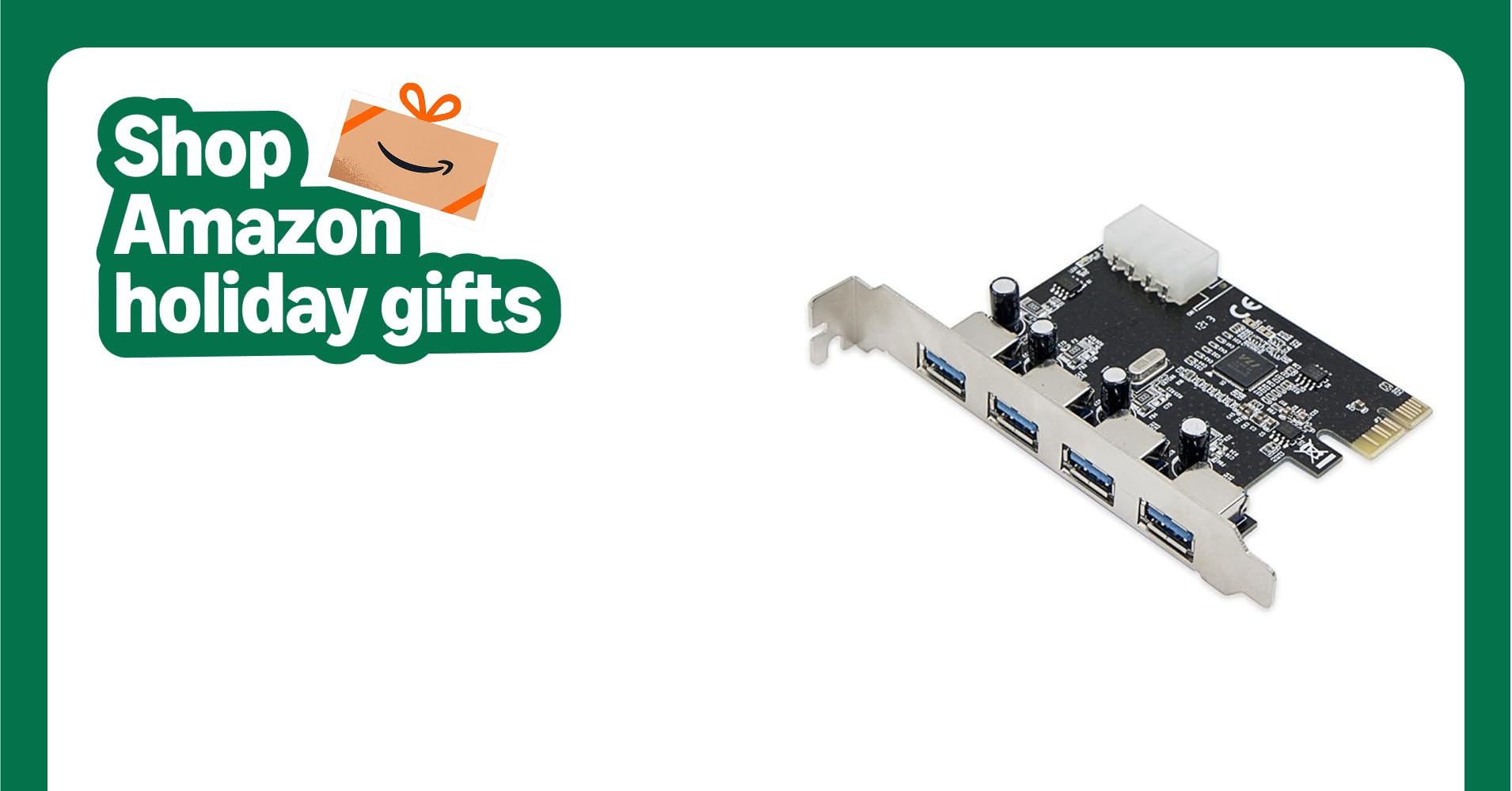

Here is an example of 4 port
https://www.amazon.com/Syba-SD-PEX20133-Port-PCIe-Controller/dp/B008AJM6H8

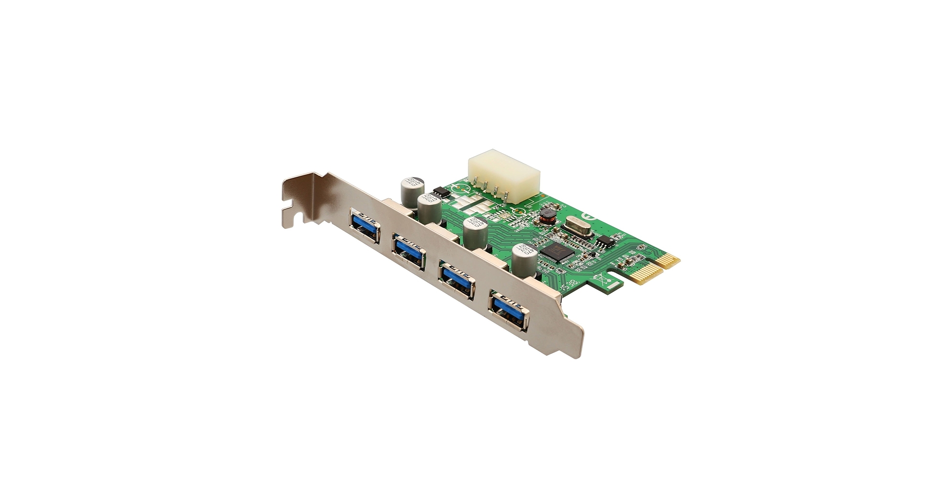

The HP  8200 is SFF, so low profile bracket is required, is this card suitable in the attached link
https://www.amazon.co.uk/dp/B01CFD2AL6/ref=wl_it_dp_o_pC_nS_ttl?_encoding=UTF8&colid=3UF8PXQ6LV5KE&c...

the 4 port you mentioned will fit the Small form factor? thanks
Hi, yes thank you very much, I have installed and it fits and works fine, I am getting nearly 3 times faster transfer rate,not sure how to achieve the 10 x faster speed or the 6 gb/s.
