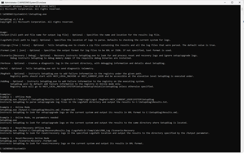

Let me know if you'd like me to:
  1. Review any setuperr.log you might find
  2. Help create a SetupDiagResults.log file using the SetupDiag tool offline
  3. Suggest upgrade mitigation steps (e.g. clean boot + staged upgrade + SafeOS workaround)

  5. Run SetupDiag:
    • Download Microsoft’s SetupDiag tool and run it after a failed upgrade. It creates a detailed log that can pinpoint the exact blocking driver or component.

Hi NonSequitur777, thanks for chiming in.
For some reason I am having issues with SetUpDiag.exe.
I already have it on C:\ So I must have tried to run it before, or, perhaps Windows put it there.
I used CMD.exe from C:\Windows\system 32\cmd.exe. I did it this way so I could right click CMD.exe and run it as an elevated Administrator account.
Once CMD.exe was loaded, I typed in C:\SetupDiag.exe
Once I did this cmd.exe outputted:
SetupDiag v1.7.0.0
Copyright (c) Microsoft Corporation. All rights reserved.
Then it outputted a bunch of parameters, to which most stated if no parameters were used, SetupDiag.exe would output a default xml file to the same directory, to which in this case would be C:\
Unfortunately, no such .xml file exists on C:\.
Please see my attached photo.
I even tried this command, still nothing:
C:\WINDOWS\System32>C:\SetupDiag.exe /Output:C:\SetupDiag\Results.xml /Format:xml
