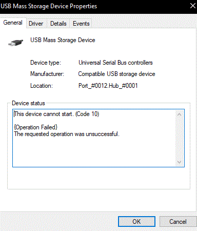

When I check my Devices on my PC, it reports that a Universal Serial Bus Controller has the "yellow" exclamation mark next to it under Mass Storage Device, when I examine the item in question using properties it reports "This device cannot start. (Code 10), {Operation Failed}, The requested operation was unsuccessful."

Its something to do with USBSTOR, since this is the Mass Storage Device that is showing up on the Device Manager in the System Properties.

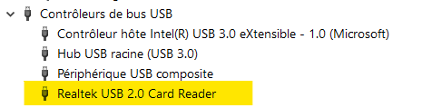

give screenshots of device manager
Where you can see the error messages, and the card reader driver

Card reader is listed, but cannot format or write to the SD card.
