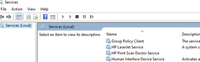

If it is not there then type "Services" into the windows search bar and scroll down to the "H" services
If HPDiags shows up then select properties and disable it or switch the startup to "manual"
