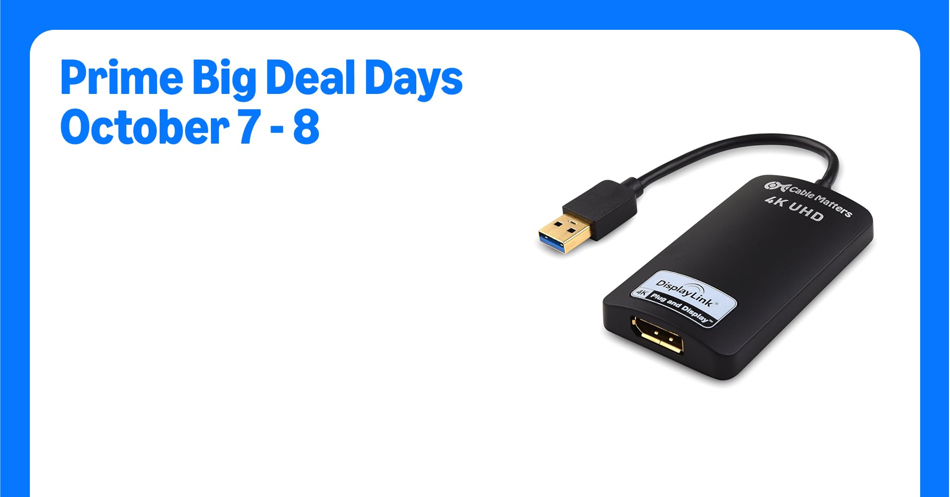

Another possible choice is this
https://www.amazon.com/Cable-Matters-DisplayPort-Supporting-Resolution/dp/B018YHTUNI

What you are seeing is what to be expected.  Using " a 2 output HDMI splitter" just duplicates the input.  To say that the second monitor is not detected, is not exactly correct as it is displaying the signal, just as it is designed.
Since the HP ENVY 750-110 does not have a second HDMI or a Displayport, then an easy option to feed a second monitor is to use a USB to HDMI/DVI adapter, similar to this
https://www.amazon.com/Plugable-Graphics-Multiple-2048x1152-1920x1080/dp/B00A2E1MQA
Don't be fooled by a non-active "cable" but get the above style adapter.  I have the Plugable devices to be very reliable.
While I have not used that device.

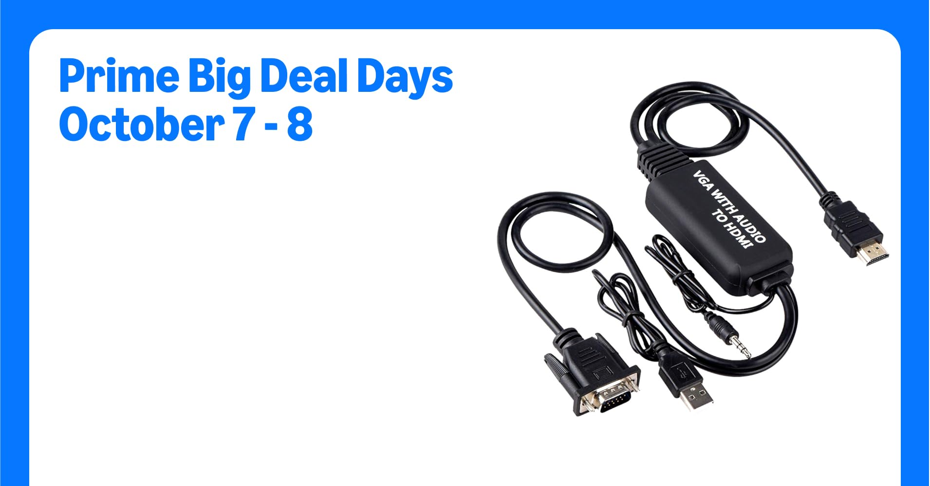

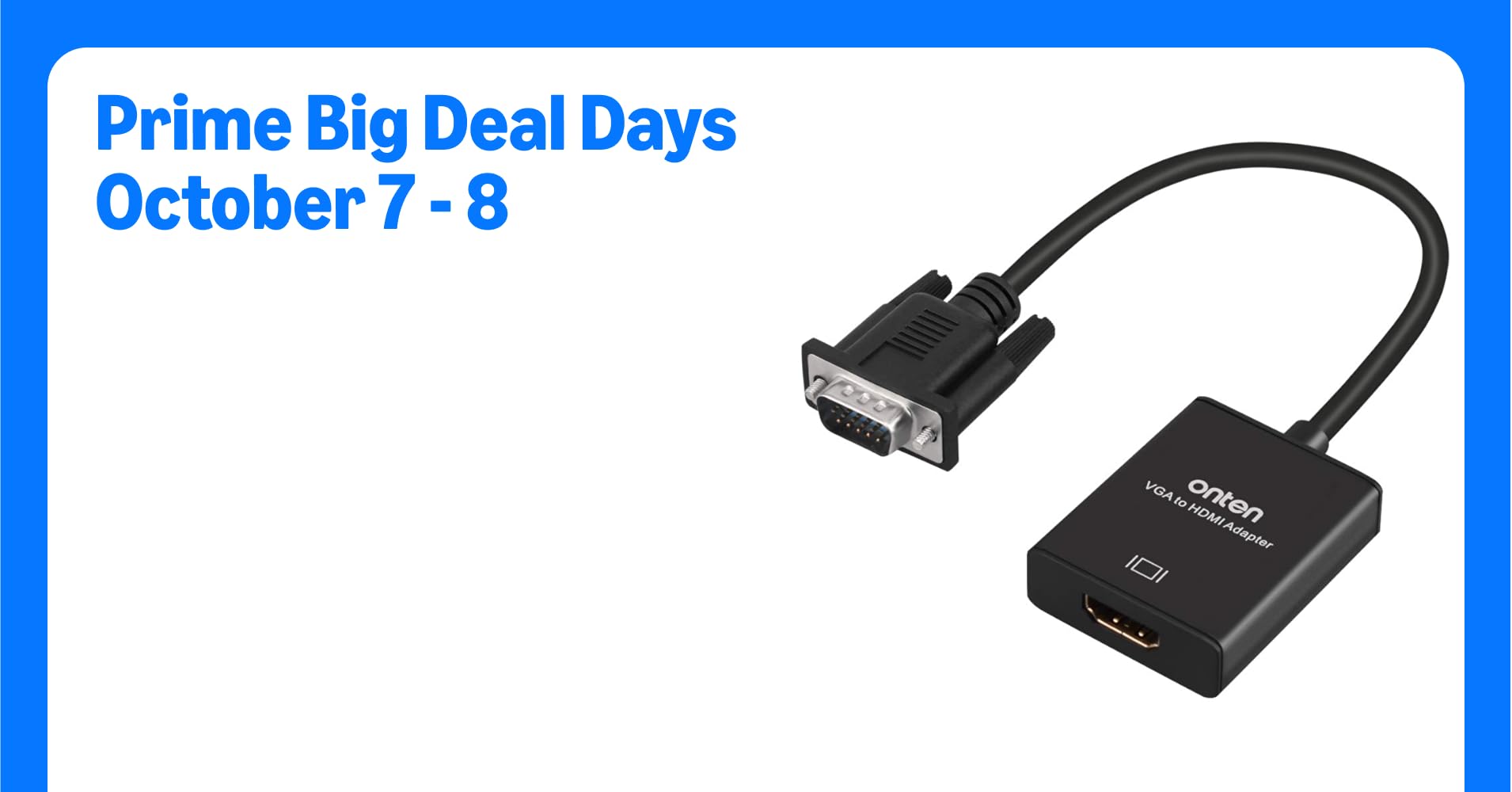

Thank you for so much for your quick response. I have been using your response to do a little research. I looked at the back of my HP Envy 750-110 again and I do have a VGA port. Could I use a VGA to HDMI adapter or cable to connect the 2nd monitor?  I want to be able to use both monitors , not just have the input duplicated on the 2nd monitor. Both of the monitors are the same, HP 27b curved, each having  1 HDMI port and 1 Display port. The first monitor is connected to the desktop with an HDMI cable.
I did notice that you had a VGA port.  Using a VGA to HDMI is possible but it has to be an active adapter, meaning it needs to be able to use power to make the conversion.  Also, since VGA does not have audio, that has to be added to the VGA signal before becoming HDMI.  Something on this order
https://www.amazon.com/Adapter-Connecting-Laptop-Monitor-Display/dp/B07S1RKD4H
OR
https://www.amazon.com/Adapter-Computer-Desktop-Monitor-Projector/dp/B07BKYBKGP
I have not used either of these, so cannot comment on how well they work.  The Plugable adapter I mentioned in my previous reply I know does work as you wish to show a separate signal to the second monitor.
