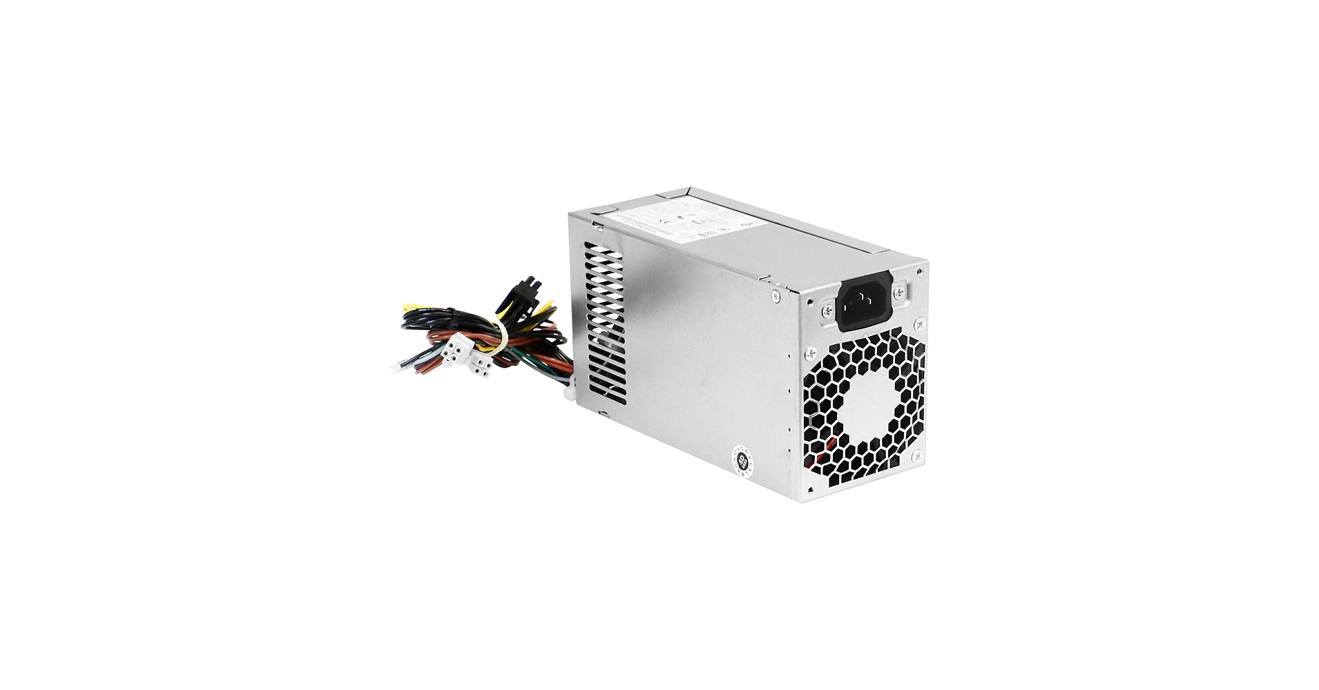

Possible Solution #1: Upgrade the PSU:
Your HP EliteDesk can only be powered by an HP-proprietary power supply, and as of yet, there are no ATX power adapters available in order to replace your PSU with an industry standard 750-watt unit.
  1. Assuming you got the HP EliteDesk 800 G3 MT/TWR model:
    • There is an HP 650-watt power supply that may be compatible with your PC and has HP part number: L57253-003 / L36049-003.  This card is available online, such as eBay.

not sure but i believe the HP PA-5501-2HA....... 500 watt supply is compatible with the 800 G3 systems which were only offered by HP with the 180/230 watt units
it should also work in the HP 480 280 288 680 800 600 400 G3 G4 24BB models
https://www.amazon.com/LXun-L77487-001-Replacement-PA-5501-2HA-DPS-500AB-51/dp/B0CJ6VNC92

you are correct, at this time nobody makes a adapter cable for the 6/7 pin 12volt only power supplies
which is why i referenced a replacement HP 6/7 pin compatible supply with higher wattage
