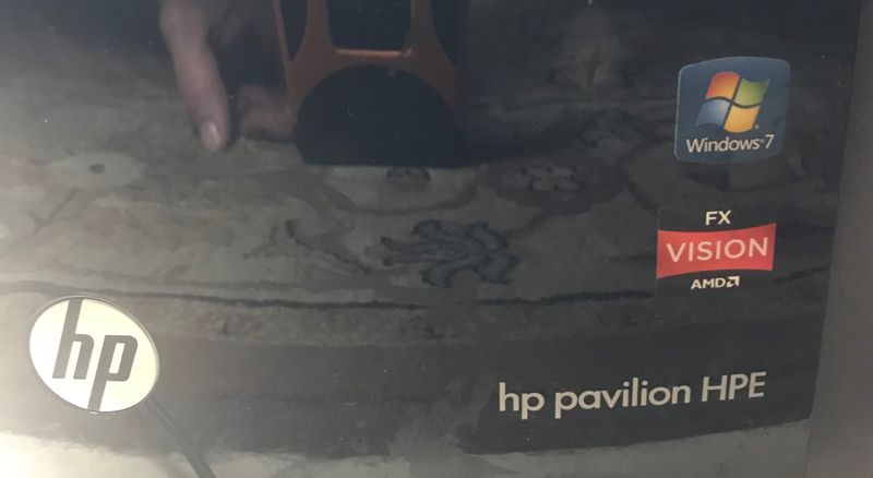

thank you for your reply -- i did read your post - however did not understand most since i am not as technical as you.  I did not know how to specifically provide the model until i read the link above and was able to locate the product number - and then i saw what i believe to be the model number albeit it is not labelled as such -- it appears that i have an HP Pavilion HPE, h8-1223 Product# H2M24AAR#ABC.
below is a photo of the front of my computer and where i was lead to believe it was named HP Pavilion HPEhp pavilion HPE.jpg
