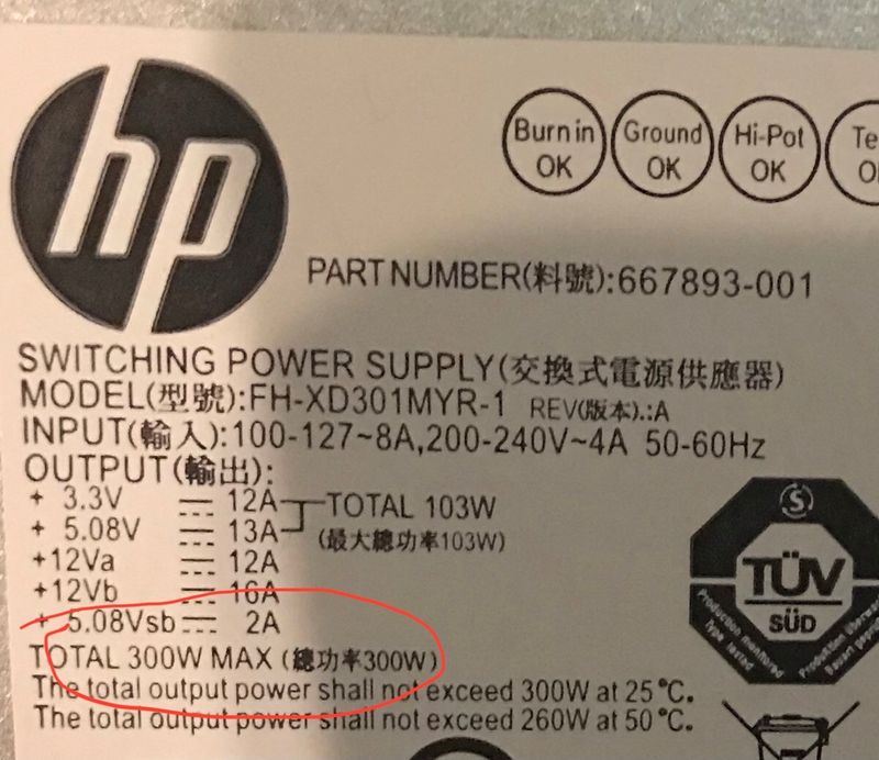

Do you know what is the power (300w / 350W, more) of the power supply of the other computer?

to answer your wattage question - I believe it's 300W and i found that on a sticker - here's a photo:
