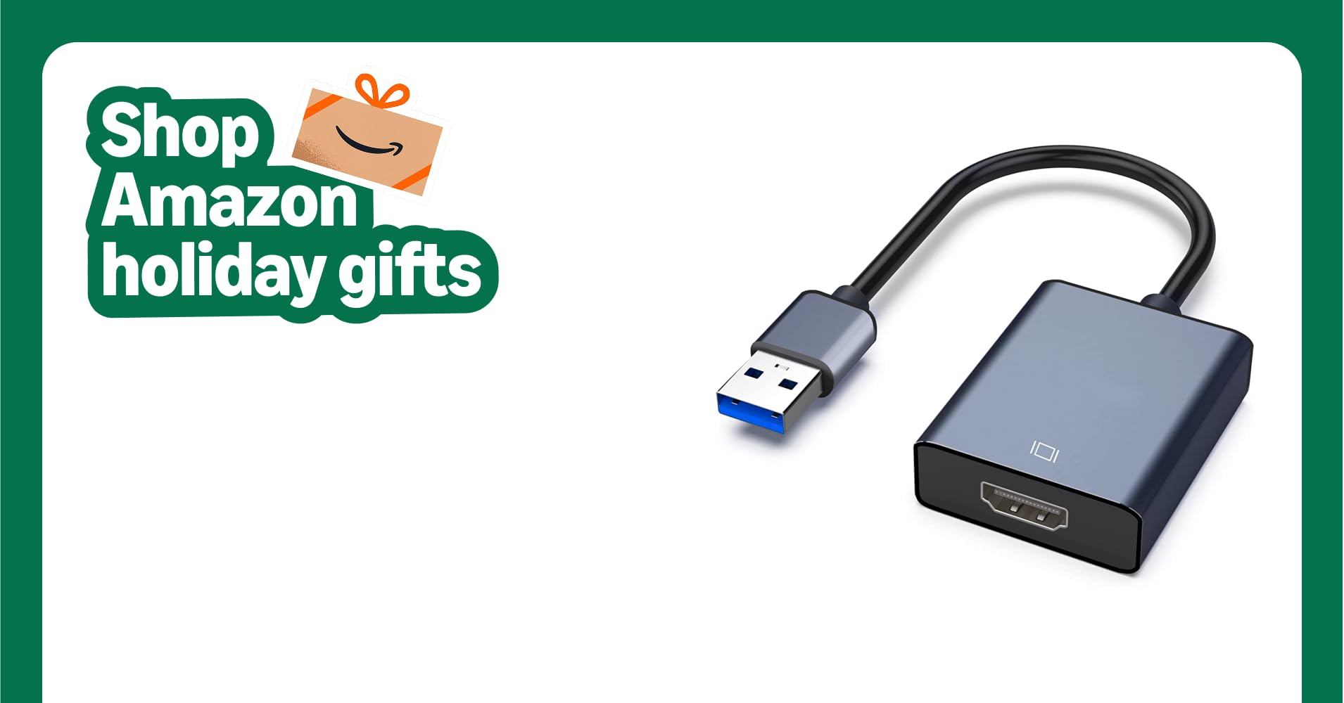

There is probably no log since you are not gaming.   Get get a usb2/usb3 adapter to hdmi
something like this https://www.amazon.com/Tuliyet-Adapter-Multiple-Monitors-Compatible/dp/B0C9J8QX3Q
Will be buying a different adapter. Thanks for the info!
