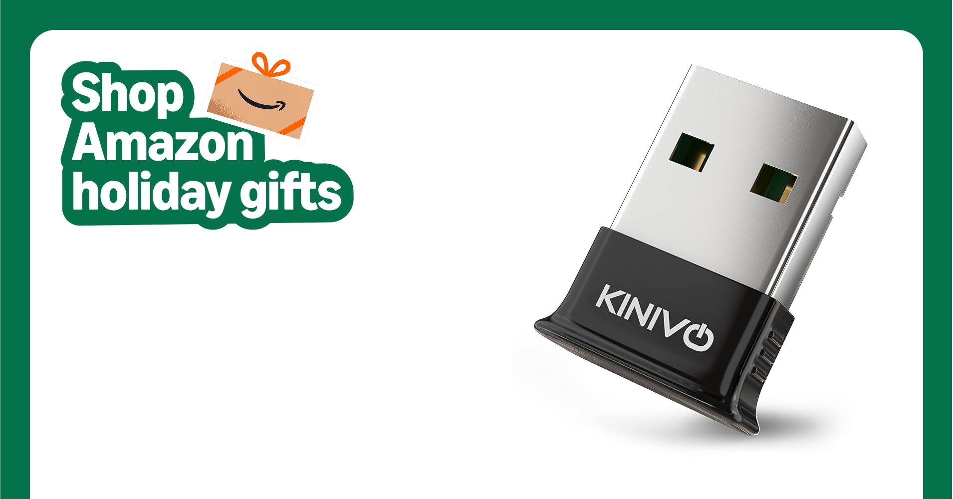

I haven't looked lately at what is out there right now (better models?), but I have two of these on my PC's one Dell and one HP and they work fine on W10.
W10 will even automatically install the driver a couple of minutes or less after detecting the device.
https://www.amazon.com/Kinivo-USB-Bluetooth-4-0-Compatible/dp/B007Q45EF4
Thanks for the suggestion. I had looked at a couple of them but if you have one and it works, sounds good to me. I went ahead and ordered.
Anytime.
It has the 'been around forever' and reliable Broadcom Bluetooth 4.0 chip, so that is why I bought it.
