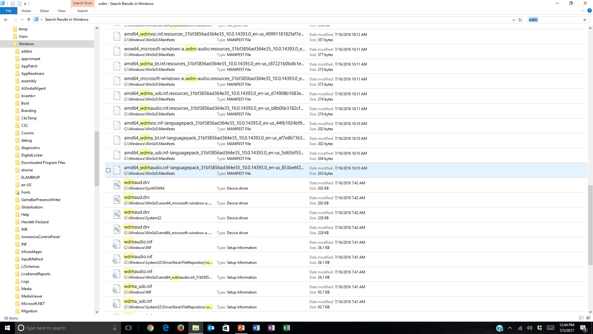

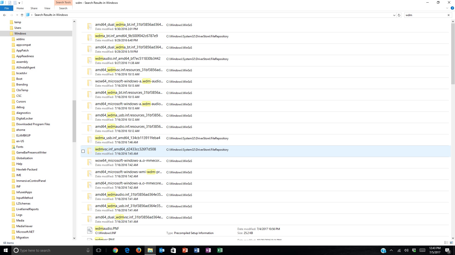

Based on the IDT File Version in Device Manager, you have the HP Win8 Driver. Let's try reinstalling it so it appears in the SWSetup Folder. Here's the download link - ftp://ftp.hp.com/pub/softpaq/sp59501-60000/sp59736.exe If it installs with or without errors, restart and see if Beats is at least in Hidden Icons. If not, see if SP59736 is under SWSetup. If it's there, find the 64-bit .inf File in the SP59736 Folder (mine was STWRT64.INF, 64 for 64-bit), possibly inside WDM sub-Folder. Look inside the most current OS under WDM (mine was Vista) and use that Path to attempt Legacy Hardware installation. Let me know which OS. If no WDM sub-Folder, use search to find the 64-bit .inf File inside the most recent OS sub-Folder or elsewhere. If not sure which .inf to use, Post what you find here. If certain which .inf to use, follow my original instructions above on 6/17 to reinstall IDT as "LEGACY" Hardware using the File Path to that 64-bit .inf File you just found. Modify step (2) on 6/17 as follows: Uninstall the IDT Driver in Device Manager, but do not restart. Here is step (3). In Device Manager, highlight the top entry above the Hardware list. Click Action, add legacy hardware, Next, select "install the hardware manually...", Next, select Sound..., Next, select IDT if there (if not ignore), click Have Disc, browse to the 64-bit .inf File you found, click open and follow the prompts. Ignore any error messages, including something like does not apply to your Hardware as was the case with mine above. Restart PC and hopefully Beats will at least be in Hidden Icons. If you can't get SP59736 under SWSetup, right-click SP59736.exe and select Troubleshoot Compatibility. Then Try Recommended Settings when offered. We still have more options. OUgrad - P.S. For future reference, If you ever use your Recovery Disc Set, contact Microsoft first to see how you can reinstall your Win10 Free Upgrade if that's what you did. I assume you will need your Win10 Free Upgrade License. You can also run Windows 7 which will be supported by Microsoft with Security Updates into early 2020.
OUGrad,
Well, again, no joy!
Here's what I did and the results:
  • I tried to install the driver you had me download in previous post and I got the same error I reported earlier.
  • Regardless, I restarted PC and Beats icon was not in System Tray's hidden icons
  • Neither SP59736 nor any sub directories other than SP files were under C:\SWSetup
  • I did a search for WDM in the Windows folder with the following results (4 screen shots)
I really do no know what is the correc INF file so I need some further help
