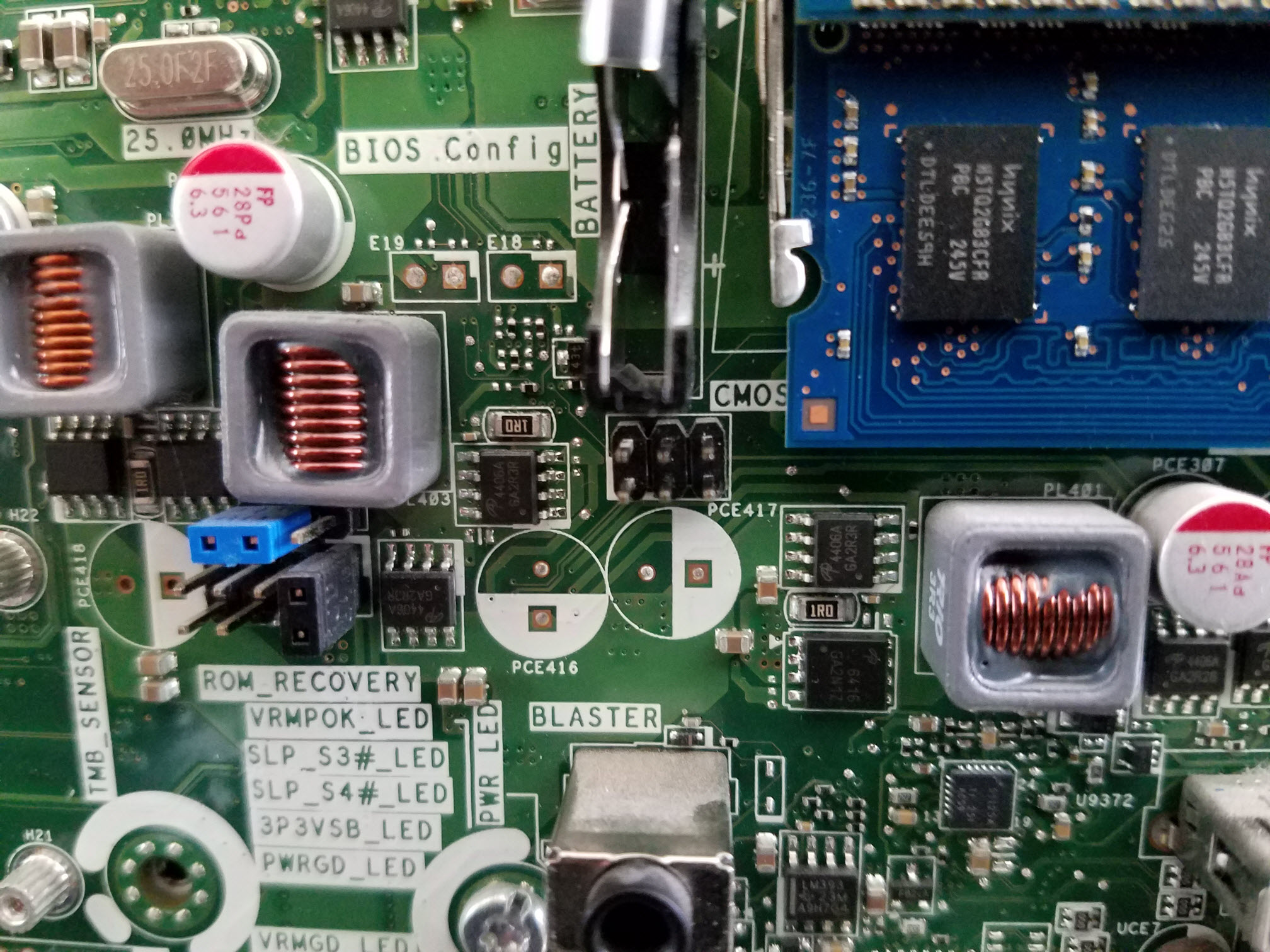

Chris, Thank you for your very detailed and in-depth reply.  I really appreciate that.  The only thing that doesn't match up with what you said is the pin count.
Here is a screenshot of my HP ENVY I registered and it states it's a 23.
Here is a pic showing the pin count with the jumpers on in the normal boot position (2-3).
Here are a few other pics with another angle and no jumpers.
I will follow your instructions again of moving the jumpers (in my case) to the 1-2 position.  I have done this almost ten times now with different time lengths (one with it sitting over night plugged in and not plugged in).  D0eb0y stated that he left his unplugged while he reset the BIOS.  This doesn't make sense to me, because I thought the computer would need some sort of power in order to reset the BIOS.
Please let me know if there is anything else I should be doing.
