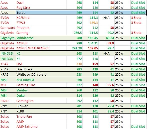

I listed some of the 2080ti cards available on the market (the list is not exhaustive and it is still a work in progress )
Specs are collected from Internet pages from manufacturers
Omen Accelerator specs for the acceptable graphic card max sizes : 330 x 140 x 54 mm
In green, with black border, shows the RTX cards with size compatible with OMEN accelerator's specs  (size constrains solely and not firmware nor PSU power compatibility)
In red, the cards that cannot be installed inside the OMEN Accelerator due to size constrains
(OMEN PSU still needs to be upgraded to 650w)
If anyone tried one of the setup above, please let us know here!
