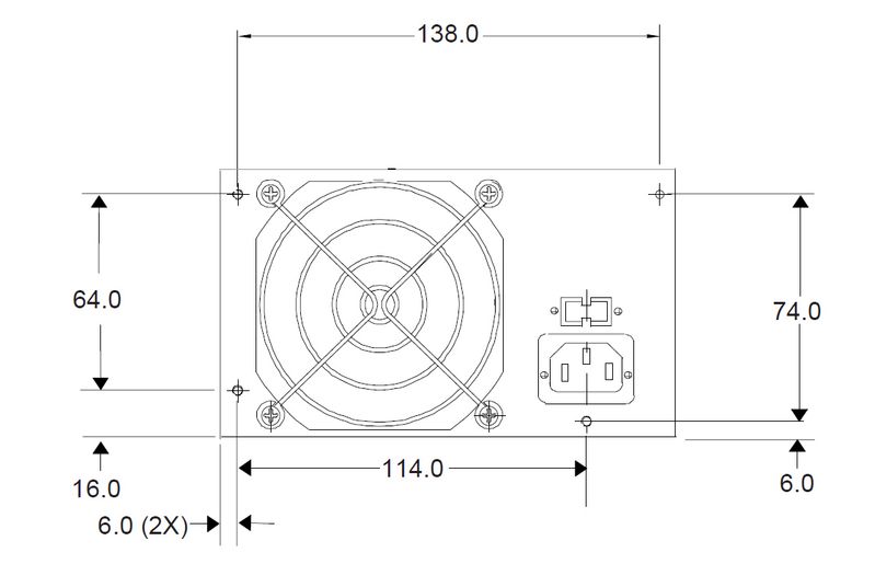

So, I'm not sure if your case has the screw holes for standard PSU's with an added Micro ATX adapter plate or not. You will have to see if it has the holes for standard available. The diagram below is measured in MM.
If so, you are in luck. I would get a standard ATX PSU. Any brand works, but I prefer to use the better brand names like EVGA, Corsair, Seasonic or Thermaltake as they have excellent warranties. If your FXF Fatboy will fit in that case, you can go 500w or up. If a higher wattage PSU is the same or lower price, it would only make sense to go that way.

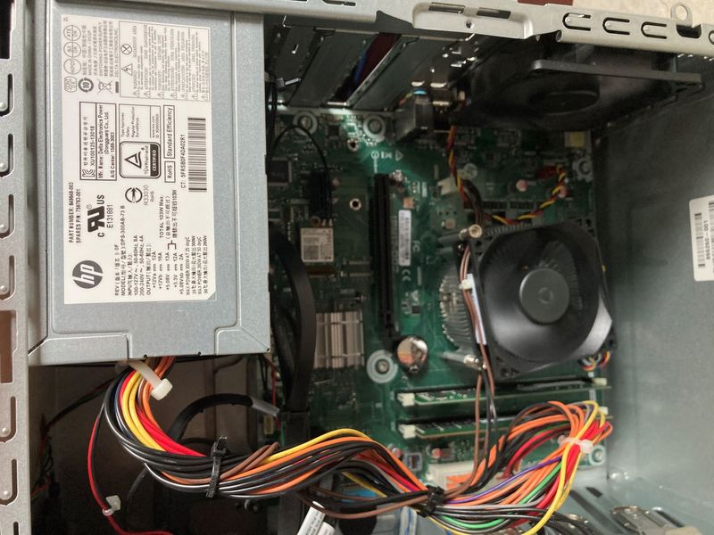

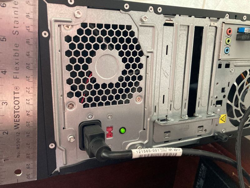

OK, Now if you will do as I ask, I can help you out. HP does not have images documented for that particular model and I just need to make sure its full ATX compatible.
Will you take a picture of the back of the PC where the power supply screws are and let me verify the pattern?
Post the image here in the forum using the camera icon above the text box when you reply.
Thanks
Although I could see the photos, now it seems like it didn't work. I'm on it.
