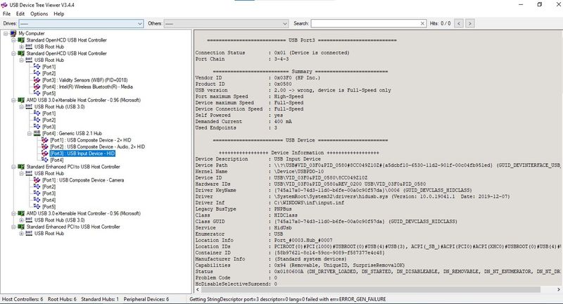

I have the exact same problem. It worked like 5 mins first time plugged in. Made an update and system restarted. Goodbye reverb g2. It then stopped working in whatever combo i tried, powered usb hub, pcie extension card etc. I also tried different pc's. no luck. here is one of my usb tree picture. this one is from my laptop. it is same with my desktop.
