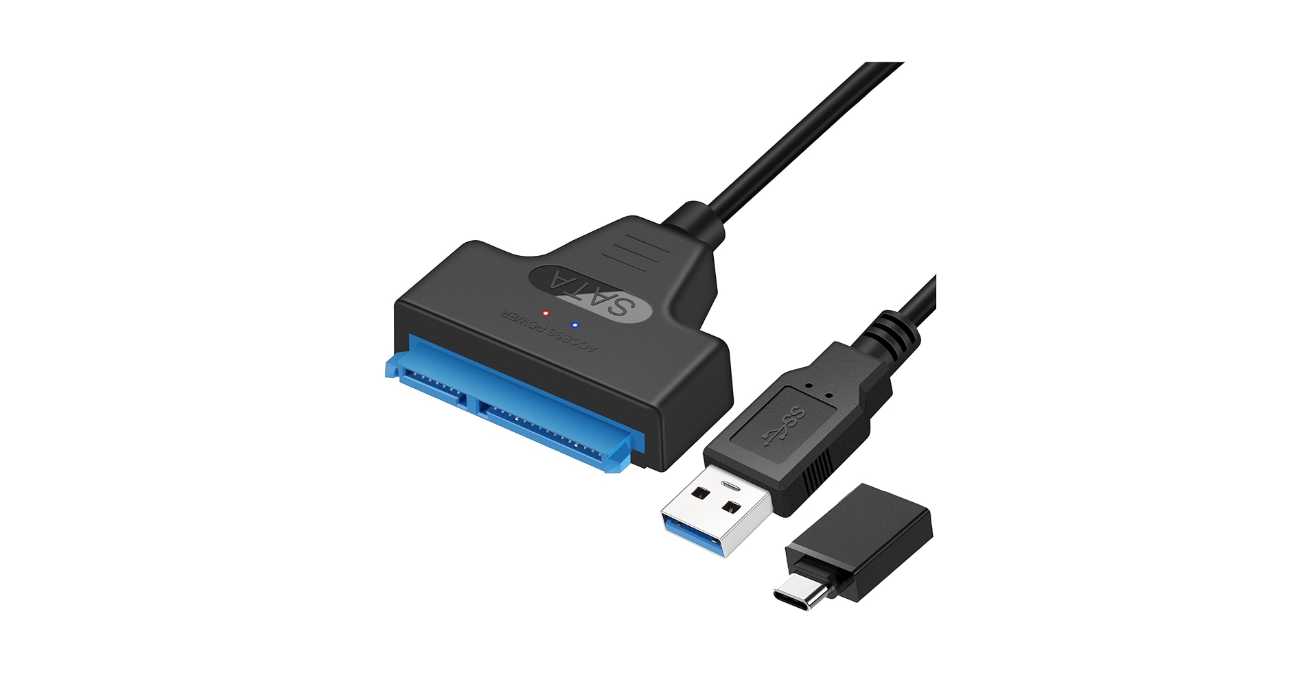

Okay so I have everything hooked up, and in the bios I saw 'device config.' And it just said sata0 1.0 tb (my failing seagate) and the cd-rom, so maybe the hard drive is dead, but it's done this before on a 2.5" drive so I put it to the USB 3.0 on the board and it saw it, maybe I should do that with this new one?
@Tebon
Yes, give it a try to see if the new drive responds.  If you don't have one, here is a very useful device for testing and using drives as backup: https://www.amazon.com/Adapter-Cable-Converter-Drives-Solid/dp/B073SXTY64/ref=asc_df_B073SXTY64/?tag...
I have one of them and use it all of the time.
