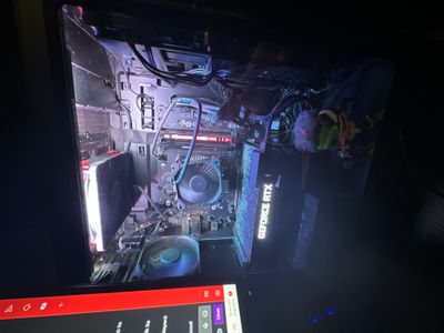

So i have a hp omen 25L and want to upgrade my graphics card, im looking at a MSI gaming GeForce RTX 3060 12 GB 15 GBPS GDRR6, 1,92 bit HDMI/DP PCle four torc twin fan ampere OC graphics care (ventus 2x 12g OC) would that be compatible with my pc? 😕

No sorry i did not understand it had to be dumbed down for me sorry new to this pc builts and tech stuff very sorry and my pc is a hp omen 25L , power supply is 500w
Sorry, your photos are of no use to me.
I would need at least the exact model of your computer ..
