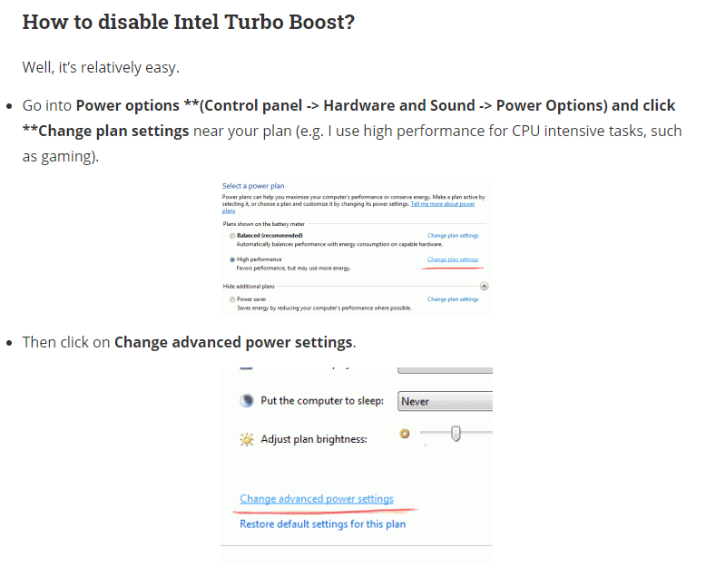

Found more to support this theory, as well as another option to disable turbo boost from control settings under power management. May be helpful if intel utility keeps reseting profiles. Looks as though this is used to fix intel over heats commonly. (disable intel turbo boost,  source Tautvidas Sipavicius)

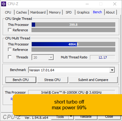

ok check these benchs out.
Looks Like the power at 99% is the issue. my benchmarks stayed the same with that at 100 and temps still stayed much better. ill try throttle stop next.
Throttle stop caused a drop as well. So try disabling short turbo. leaving max power at 100. Set up a pairing profile in intel extreme utility so that it activates that profile at start up with another program. I use voicemeeter as I always have that on. Let me know how that works for your set up.
