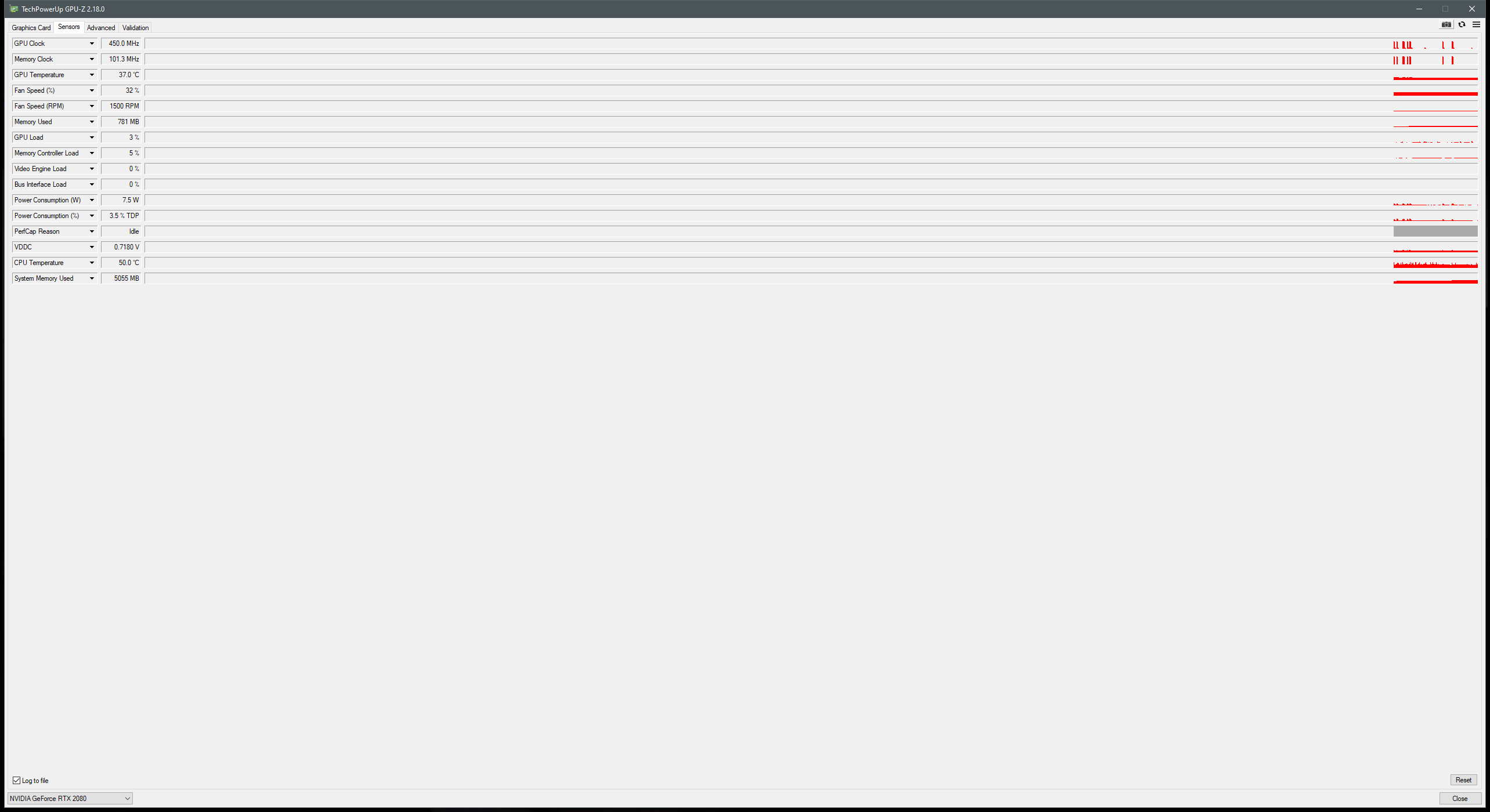

The FurMark thing crashes almost instantly
What voltages / temperatures you're seeing under the 'sensor' tab?
Can't see much but it all looks normal to me.
FurMark crashing and the fact that you're not able to play any games is quite suggestive.
If temperatures are normal, your cable to monitor is of a good quality and you do not overclock the card either (you don't, correct?) then my thesis is that it's the graphics card memory that's playing up.
So that's something that you should test.
