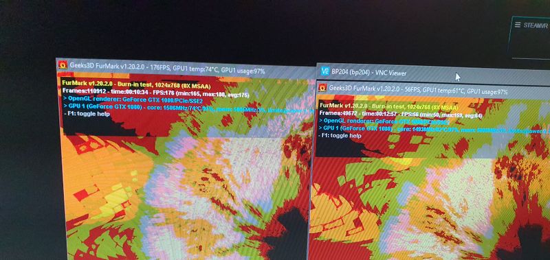

Hi, we did exactly as written. 100%
But the problem on this PC still remains.
Please see both tests
You can see the problem. One is good Omenx and second is the bad one.
Both connected to same type of PS , original with 2 batteries full charged inside the backpack.
Please help.....
