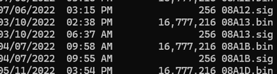

The service agent should have extracted the bios from the drive.  It can be done as follows assuming the drive is not corrupted
The bios is in one or more of the three folders
The folder HP Tools is in a hidden partition.
The agent should remove the drive (M.2 ssd ?) and attach it to a USB adapter.
The drive will show up as a hidden partition probably "EFI" or "HP Reserved" or maybe "Recovery" depending on the model
It can be unhidden by assigning a drive letter using the administrative tool diskpart
for example
Once assigned the "m" drive can be accessed. Look for HP Tools and pick a bios.
this 8 year old app may or may not be easier to use than the above
If the drive is corrupted then try either of the bios found below

Below is the report from the repair company:
Following the step-by-step instructions provided and downloading the BIOS file from HP's website, the files were extracted from the executable provided by the company. The original file installed in the BIOS chip was read using an EPROM programmer to identify the correct file, as HP provides more than one option. The 08A13 file, with 16MB, which is compatible with the motherboard model, was used. I also reprogrammed with other files provided by HP as an attempt, but it was not effective either. I then restored the machine's original file.
They had previously told me that this method would probably not work, according to them the BIOS files in HP website are only updates, and they wont work alone, needing an original BIOS.
Does that make sense? I have little to no experience in such a deep subject.
They download the bios in the ROM and looked at it to verify the ROM ID 8A13.
This is normal procedure as discussed here (downloading the existing bios)
They downloaded the bios from the motherboard, saw 8A13 and found the matching 8A13 on the HP web site.   This was then reflashed and did not work so they tried older 8A13 versions
However, I looks like (I am guessing) that 8A13 is NOT the correct bios.
it is either 8A18 or 8A1A
Both of these were released just this Dec 2024 here
If they tried the 8A18 or 8A1A and they failed then I suspect the system is damaged beyond repair.
I did find an 8A13 bios at HP in the 2022 crisis recovery folder.  Possibly that is the same one they tried. Maybe not???
