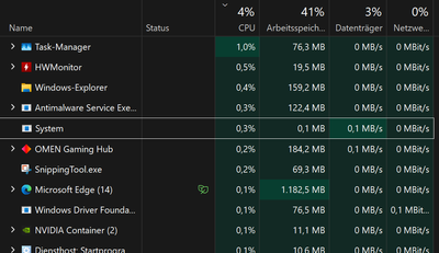

3. Background processes: As I said, it is really low and there is no strain on CPU/GPU during idle mode, as seen here:

And like I said, my brother got the Omen Transcend 14 with the Intel Ultra 9 285h the other week and it does run a bit hotter but the Transcend 14 stays completely silent. This does not make a lot of sense as it was for him like this out of the box and for me there was fan noise out of the box. Interestingly enough, he does not have the BIOS setting to toggle off "Fans always on" so I believe this BIOS option does not work correctly as of now as I can have put the Omen Max into a fridge, having the SOC at 5°c and fans will still power up immediately after bootup so it does not seem to be correlated to a minimum temperature.
