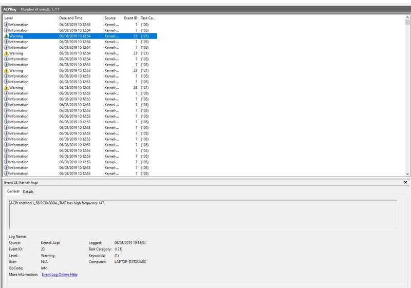

I did the logman thing you suggested. I find something I didn't expect. The "warning" logs don't mention \_GPE._ L6F but the following ones:
_SB.PCI0.B0D4.PNG"ACPI method \_SB.PCI0.B0D4._TMP has high frequency 31678." (something within "Intel(R) Dynamic Platform and Thermal Framework Processor Participant"?)
"ACPI method \_SB.GEN1._TMP has high frequency 20231."
"ACPI method \_SB.GEN2._TMP has high frequency 17993."
and less frequently:
"ACPI method \_SB.BAT0._BST has high frequency 3975." (battery status?)
"ACPI method \_SB.ADP1._PSR has high frequency 3974." (adapter?)
I don't know if I did it right or if at that time was at some heavy usage to trigger these ones. Under linux the issue was always GPE.L6F besides the logs from boot screen about some errors in acpi firmware.
(EDITED: added screenshot).
No worries, these methods seem to accompany GPE.L6F, maybe you didn't stumble upon it due to sheer number of entries. If you stumbled upon it on Linux then that's it nonetheless.
