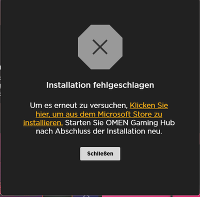

It does not let me install the latest version. Seem to cannot upgrade from 0.1.8.0.
And if I want to install Omen Light Studio separately from the Store, it simply wouldn't start the installation, no matter how often I click that Install button.
