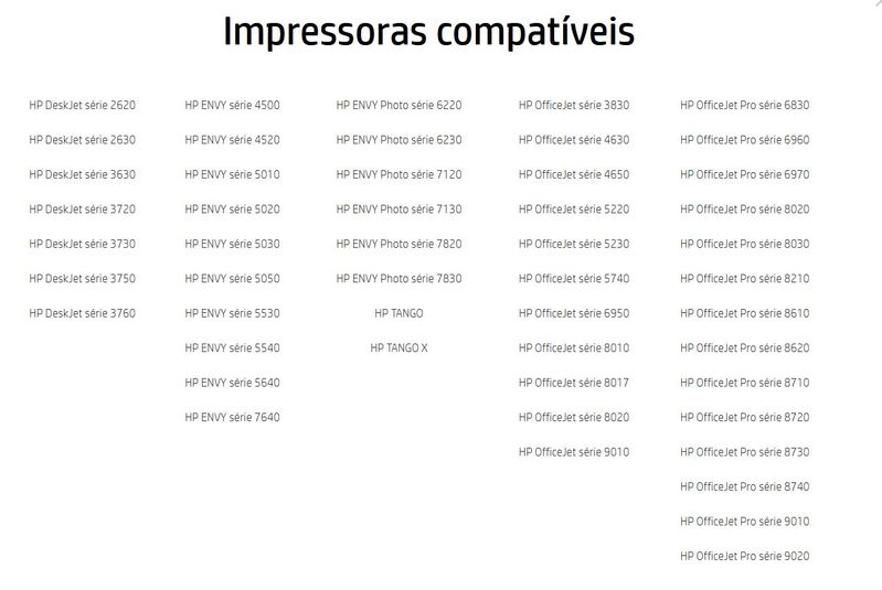

Is your printer model really an Officejet 4610 printer?
The HP Officejet 4610 model is not supported by HP Instant Ink, the service does not support older printers which uses HP 364 cartridges...
What is the number listed on your HP Instant Ink cartridges? I highly doubt those are intended for your printer, assuming you did provided the correct printer model.
Here are any supported HP printers for HP Instant Ink, the Officejet 4610 is not included among this list:
Please clarify your exact HP printer model and the supplied ink cartridge number.

Yes, you are right,
I have an HP OfficeJet 4650 All-in-One printer.
Thank you for correcting 👍
Cartridges number 63/302 (add a photo)
P.S. I corrected my initial message
