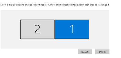

I am confused.
The sender is my desktop workstation with two monitors. The MAIN display [Display1] has the program I am running and Display 2 has support information related to the program and affected by the running program.
When working remotely I do not need the second display, and do not have another monitor to plug into the laptop.
The only updates are those that windows has auto installed, all cumulative or version updates. the version update was just last week and after this problem appeared.
I sent about an hour testing all of the possible configuration changes that can be made on the Display Settings page and nothing affects or changes this other than "Show only 1" or "Show only 2."  Of course, the problem goes away when Display 2 is unplugged from the Displayport. It is still there if it is plugged into the Displayport and just shut off!
That reminds me. Originally, I borrowed an old VGA display, it was plugged into an adapter to convert VGA  to HDMI cable and the HDMI cable was plugged into a HDMI to Displayport adapter.  In July I replaced this monitor with a New HP X24I (w/DP connection] to match the color rendering of my ASUS ProArt Monitor.  Is this why the  RGS Sender did not think anything was plugged into Display 2 ? ?
