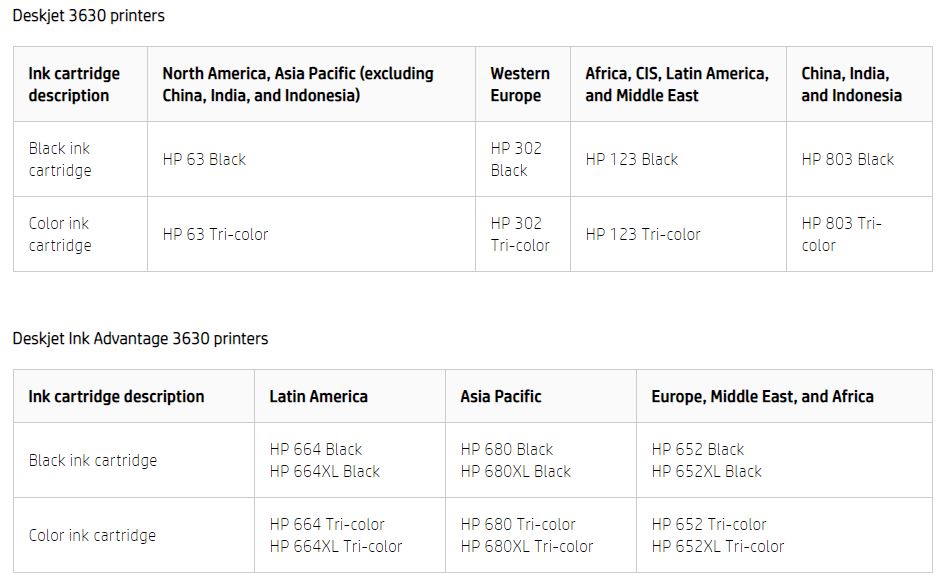

Step 2: Check the cartridge compatibility
- Make sure you are using compatible ink cartridges
