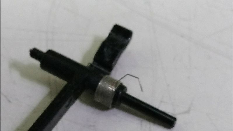

Hi ,Again. many thanks, The bottom part of the sensor flag ie. the "flag "end was laid at the bottom front of the machine and the top part was down where the photo diode sits.I`ve managed to glue the two parts together with the plastic pipe weld that plumbers use and I`m going to splint it with two tiny rods and bind it with very fine copper wire and then epoxy resin it.Pity I don`t have a 3D printer!
However ,i`ve searched everywhere for the spring without any luck.Do you think its possible that its pased through the hole in the chassis where the photo diode is and onto the pcb?
I`m surmising that the spring is a fine hair spring as it`s only the force of the paper travel that tensions it and repositions it after the sheet passes through? From memory can you confirm how much tension the spring produces e.g does it feel very light?
I`m asking this because I`m busily seraching searching through my workshop looking for a spring I can convert.I have a clear picture of it to work from.

Maybe the hair spring from an old clock would do it?
02-23-2020 07:53 AM
Hi, many thanks for your reply, the close up pictures are great and will help.I`ve managed to sort of "repair" the flag (bit of a botch) but the spring eludes me ,i`ve searched everywhere for it,even had the PCB out of the bottom .
That spring in your close up looks very tempting ,are you sure you really need it! LOL!.
Can you tell me how sensitive is the spring it looks quite delicate?
