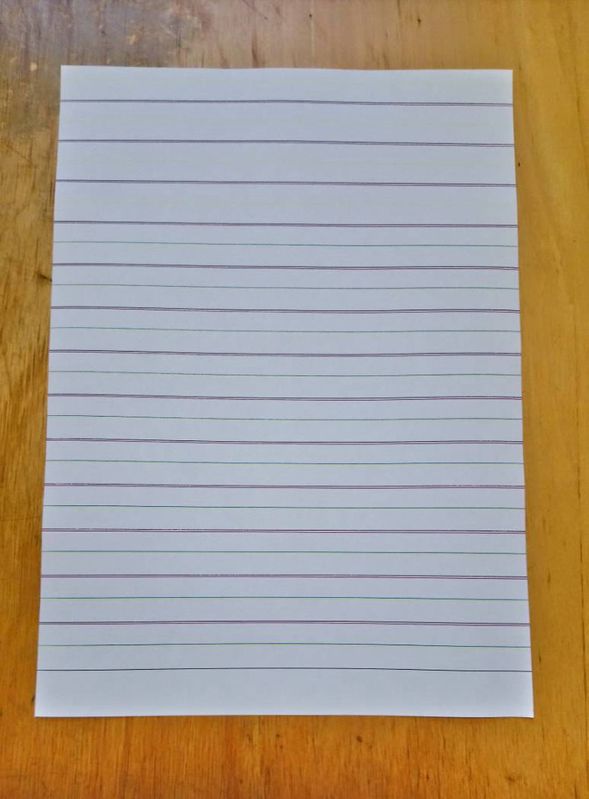

Run an engine test by opening rear & front door under power-off then power-on and close both doors in ten seconds.
It prints out all four colors fine.
