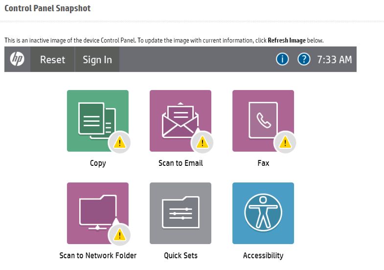

Which version of firmware are you using FutureSmart 3 or FutureSmart 4. FutureSmart4 offers much improved interface and flexible configuration. For instance, you can place the print from job storage icon directly on the main screen so there is no paging through options.
FS4 Control Panel Sample
