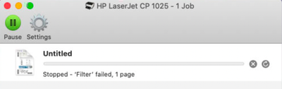

03-17-2020 09:45 PM
Hi Asmita,
I have done all you suggested.
Easy Start seems to have problems connecting to the printer.
However the printer shows in printers and scanners.
This is what I get printing a PDF in Preview or Safari
Still not working.
Help please
Kindest regards
Jon
