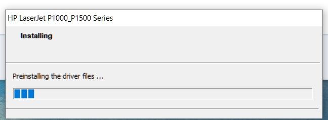

System is Win 10 1809 pro. Here is what happens:
- Check for old driver instances by printui/s, reboot
- Install driver ljP1000_P1500-HB-pnp-win64-en from HP Product support site (no difference whether I run it AsAdmin or straight away)
- It goes up to about this stage, then disappears:
- No other dialogs, e.g. 'connect printer' are shown
- Reboot
- Connect printer, windows shows message like 'HP p1006 is configured and ready to use'
- Alright, it appears in Devices and Printers, but not functional at all:
- On system drive there is strange folder set created: C:\Program Files\HP\HP LaserJet P1000_P1500 Series\HP\HP LaserJet P1000_P1500 Series\HP\HP LaserJet P1000_P1500 Series\HP\HP LaserJet P1000_P1500 Series...
- When I try to print something - nothing happens, just tasks stuck in queue
- It is shown in Device Manager in Software Devices node, but not in Printers
- When I try to manually install driver from Device Manager, error happens:

[10-16-2019 11:29:32:487]- LOG(158C): SetupCopyOEMInf failed gle=2
[10-16-2019 11:29:32:487]- LOG(158C): PreInstallDriverFiles()
[10-16-2019 11:29:32:487]- LOG(158C): _PreInstallDriverFiles()
[10-16-2019 11:29:32:487]- LOG(158C): inf:C:\Users\Maria\AppData\Local\Temp\7zS19F5\hpljp1005.INF
[10-16-2019 11:29:32:789]- LOG(158C): DriverPackagePreinstall = -536870141, flags=0x14
[10-16-2019 11:29:32:789]- LOG(158C): ===>>> ERROR (gle=-2146499837, 0xe0000303): Msg: (null) Context: DriverPackagePreinstall failed
[10-16-2019 11:29:33:791]- LOG(158C): _PreInstallDriverFiles()
[10-16-2019 11:29:33:791]- LOG(158C): inf:C:\Users\Maria\AppData\Local\Temp\7zS19F5\hpljp1005.INF
[10-16-2019 11:29:34:094]- LOG(158C): DriverPackagePreinstall = -536870141, flags=0x14
[10-16-2019 11:29:34:094]- LOG(158C): ===>>> ERROR (gle=-2146499837, 0xe0000303): Msg: (null) Context: DriverPackagePreinstall failed
[10-16-2019 11:29:34:094]- LOG(158C): Diffx Preinstall FAILED, trying SetupCopyOEMInf: C:\Users\Maria\AppData\Local\Temp\7zS19F5\hpljp1005.INF
[10-16-2019 11:29:34:094]- LOG(158C): ProcessFailure(3) NEXT=0, BACK=1, CANCELED=2, FAILED=3
[10-16-2019 11:29:34:094]- LOG(158C): _PostProgressMessage hWnd=0x4068a msg=1129, param=0
[10-16-2019 11:29:34:094]- LOG(158C): InstallSequencer() step = 4

[10-16-2019 11:29:36:365]- LOG(158C): SetupCopyOEMInf failed gle=2
[10-16-2019 11:29:36:366]- LOG(158C): PreInstallDriverFiles()
[10-16-2019 11:29:36:366]- LOG(158C): _PreInstallDriverFiles()
[10-16-2019 11:29:36:366]- LOG(158C): inf:C:\Users\Maria\AppData\Local\Temp\7zS19F5\hpljp1005.INF
[10-16-2019 11:29:36:674]- LOG(158C): DriverPackagePreinstall = -536870141, flags=0x14
[10-16-2019 11:29:36:674]- LOG(158C): ===>>> ERROR (gle=-2146499837, 0xe0000303): Msg: (null) Context: DriverPackagePreinstall failed
[10-16-2019 11:29:37:675]- LOG(158C): _PreInstallDriverFiles()
[10-16-2019 11:29:37:675]- LOG(158C): inf:C:\Users\Maria\AppData\Local\Temp\7zS19F5\hpljp1005.INF
[10-16-2019 11:29:38:054]- LOG(158C): DriverPackagePreinstall = -536870141, flags=0x14
[10-16-2019 11:29:38:055]- LOG(158C): ===>>> ERROR (gle=-2146499837, 0xe0000303): Msg: (null) Context: DriverPackagePreinstall failed
[10-16-2019 11:29:38:055]- LOG(158C): Diffx Preinstall FAILED, trying SetupCopyOEMInf: C:\Users\Maria\AppData\Local\Temp\7zS19F5\hpljp1005.INF
[10-16-2019 11:29:38:055]- LOG(158C): ProcessFailure(3) NEXT=0, BACK=1, CANCELED=2, FAILED=3

Please advise 🙏

Hi @Timur-san,
Try installing below drivers, then let me know if you may see any difference:
https://ftp.hp.com/pub/softlib/software12/COL21058/bi-55383-8/ljP1000_P1500-HB-pnp-win64-ru.exe
Please let me know the results,
Shlomi
